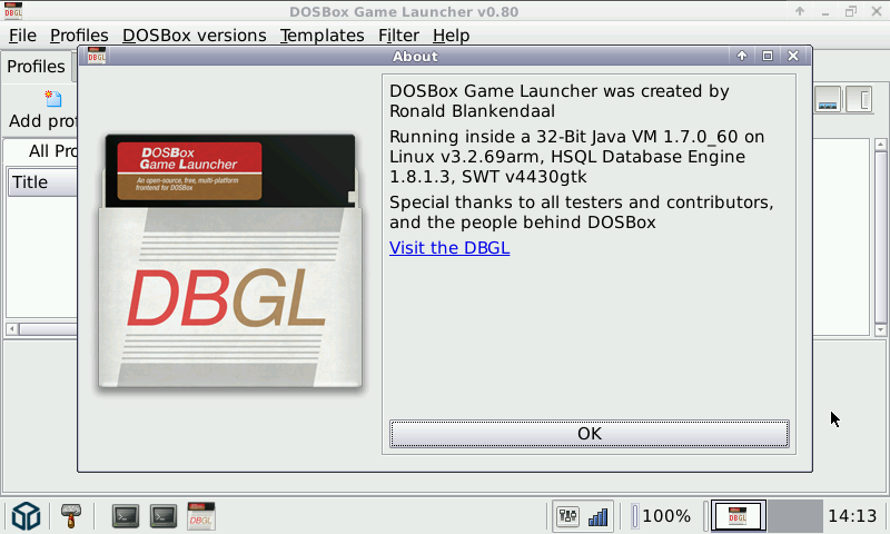

Here is DBGL, a DosBox launcher in java, plus latest version of Dosbox with 3Dfx hardware wraper
The DosBOX version is quite fast, and Dos4GW software are somewhat useable on the Pandora. 3Dfx hardware emulation is included, and is using OpenGlide (+gl4es). The required Glide2x.ovl will be availbale in the DosBox virtual drive and shuld replace orginal Glide2x.ovl supplied with the game. I f you don't find any OVL file, chanses are that the game was staticaly linked with Glide and will not work with the wrapper.
OpenGL rendering is avalable (to have scaling).
