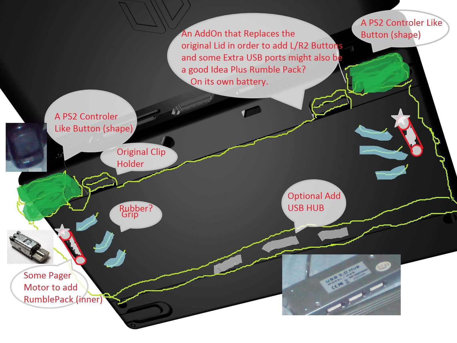

The idea I had when I asked about expansion was to make a box that would connect to the USB port at the back and maybe clip onto the front or into the battery port to keep it secure. Some sort of ribbon cable could connect the USB port to the inside, where you could put a 2.5" HDD (or 1.8"), or stuff in some other USB-based devices. Will be easier to figure out how to make a case for it once the Pandora's in our hands. Could also move the battery to the bottom of the box, using the battery bay as part of the attachment area.
I drew a quick sketch of my idea. I liked your extra button idea, so I hope you don't mind me putting it on there. :)
Link if the image doesn't show: image

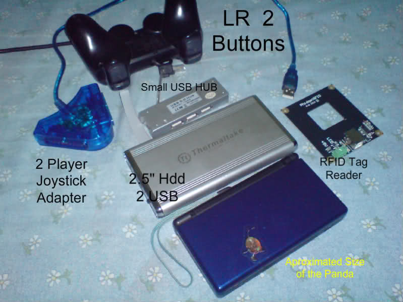

MEN! you just came up with the same think i was making!!.
just that instead of making it all, i would try to adapt a 15USD HDD case i dont use anymore, then add the xtra buttons and the rumble pack
all in a single add on. the issue here is how much current are we going to get to feed all of this.
im also worried about how to get a Disc burner to work up with the panda, since im a Backup Maniac this would be a very good use if everything worked perfectly
just wanted to fit some of these stuff to the panda
One thing I thought might help the power thing was to pass the battery power through the expansion case, or attach a separate battery to it. I've no hardware experience so I'm not sure if this would work or not. Relocating the battery to the bottom of the expansion case could allow the expansion case to attach to the battery cover rails (?).
From the mould creation time thread, EvilDragon mentioned that there are L2 and R2 solder pads for more buttons. I suppose you could drill through the case and wire up the extra buttons (or add some sort of plug to connect it to the expansion case).
I think it might be fun for modders who wanted to add extra stuff to have a kind of easily-attachable fitted case they could mod. Maybe there could be a grid on the inside of the case that could be cut to fit parts. A USB cable connected to a board with solder pads on it would be helpful, too. Adding buttons to it would make it even better. ;) But this is all just me having fun dreaming. :P
For a disk burner, perhaps a self-powered external might work? Then all you'd need to do is make sure the kernel supports it, I think. I have a 5.25" external burner that I'd like to test on Pandora once it arrives.
Edit: lol WOW you wanna add a lot to it! That'd be great if you can get all that to fit into one case. Stuff I think I'd add to it, maybe GPS, 2.5" or 1.8" HDD, extra buttons, maybe a couple more USB ports (I have 2 on my laptop and it's too little), perhaps a 3G modem...

Building a powered USB hub into it - great. Any solution like this is going to need to connect to the USB-A on the back. Right? A USB-A connector end with barely a nub extending from the case with a ribbon cable wrapping back into the expansion lid would be about ideal IMHO.
Where to get power from... Tap into the main battery at the plug or pads where it connects to the Pandora. Use the guts of a 7 port hub. Put a switch into the expansion so that it only turns on power draw IF the USB-A on the Pandora is active. Also have a switch on it somewhere so that you have the option of turning all this extra junk off.
Shape the new lid like a wedge, thicker in the back. Keeps a more streamlined style.
Under the front edge of the expansion lid put 3 SDHC card slots (only accessible with the back removed). Run these off of 3 of the 7 USB connections.
If you need rumble, link it through one of the 7 USB ports as a USB sound card and a set of cross-overs to limit it to just very low frequencies - put in two on the far outside edges for 'stereo rumble'.
Put the guts of a 2 button USB laser mouse into the center of it. Run the buttons to extensions going back left and right beyond the battery door to the rear. This way you can move the whole unit on a table or your leg and have it move the cursor on the screen to match. Bonus points if you can get the scroll wheel incorporated somehow.
Run the remaining 2 USB out the back as powered USB A slots.
Make the whole thing only add 2mm to the front and 6mm to the back on the bottom of the Pandora. Remember that it can actually extend past the back edge of the existing battery door between and to the sides of the clips AND use the space that would have been the old cover. Would likely need to build in a support to keep the battery from crushing all these bits.
OK, so the above would probably cost as much as a second OpenPandora console - but I prefaced this with 'Dream'.

@TJ,
my actual HUB (In the photo seems to be smaller than targus one)
im rethinking about the Hub and it will be better to fit it poiinting at the back (so no Mem Stick Sticks Out towards the user)
it has 3 ports one side and i expect to leave one internal to the addon casing to connect another aparathus (im still working on it, sort of a IRDA controler/2.4Ghz Tranceiver, or an Accelerometer, GPS,GSM Modem etc. depending of future uses of the panda)
3 ports is more than enough from and for my uses.(i have to live with it my laptop only offers 3 ports and i hate to carry the HUB (Even if it is so small)
it should be conected to the expernal USB port, (and ive got a Connector Ribbon Solution, looks like the nano BT but rolling a buss downwards)
about the L/R2 buttons, since we are still not sure how to connect them, i expect to make the conector so it could go out to the EXT port (if useable) or towards the inner of the panda (where the battery holds (seems to have some openings enough to fit signal cables so no drilling.).
the shaping of the both sides should be round to make the panda more ergonomic and enhance the grip.
and as being roung it could hold about 2 AA batts enough to feed the 2 hungry pager motors.
for all of that, i expect to use up some bendable wires PET bottle cuttings and Rally Epoxy putty.
the HD would be a later add on since i havent seen any External 1"8 HD that implements its connectors. but i believe it will use the Pandas USB Power so no need of extra (i would take a guess and if the HD Fits On the Batt Space and if i find an External 1"8 HD case ill be modding it for sure)
i dont know why but i look at grench post and it seems more like a joke than a real effort once the panda is out. (who would need that much stuff in a portable console/netbook)

Find a thumb-sized USB audio device - crack it, gut it, use it to trigger the rumblers.
OR have the cable that wraps to the back of the Pandora also connect to the expansion port - there is an audio out signal there to be had.
For the lasers, buy a mogo mouse, gut it and mount the hardware in the new battery cover. Heck, it could even connect via bluetooth and save a USB port for something else.
http://www.newegg.com/Product/Product.aspx?Item=N82E16826639005&cm_re=micro_mouse-_-26-639-005-_-Product
For the 2nd shoulder buttons, skip the solder points on the Pandora board and use the left/right buttons on the Mogo - extended out to the corners so you can get to them.
There are also USB thumb-drive like accelerometers and ATSC video tuners and GPS - all of which could be cracked open and scavanged.
All of the components for my ideas exist - scavaging them from commercial products would be costly. Many of them would require micro-soldering equipment and expertise to adapt.
However, if added case depth were ignored and you're willing to have a Frankendora - you could skip cracking cases and just duct tape it all together. All of it exists - putting it all together neatly in a commercial grade product - that could be a real challenge.
