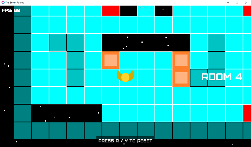

i didn't consider it rambling at all. nice format, and you made good points. not overly zealous for freedom, but highlighting the ramifications of our lack of it.
in case you didn't know: velocity and acceleration would each be a 2d vector if motion is constricted to a plane.
fuel should only need to be used up with acceleration.
i always wanted to make a relativistically correct 2d space game like this. but then, velocity is always relative to something else, so you wouldn't be able to write an absolute velocity in there...
In most of the universe, in a realistic relativistic game you'd automatically be in the orbit of something almost wherever you are, but I'm not sure motion relative to your mass center is a useful metric for a video game.

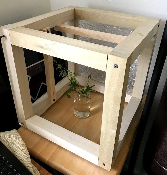

i had some wood sitting around (for about 2 years) for a box that was going to become a lamp, but now i think i'll put a vine-y type plant inside of it. still have one side with the frosted glass-type plastic though, kinda looks cool.

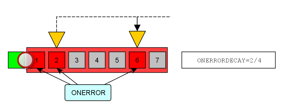

I'm working on a monitoring tool (on and off for a few years now).
It includes all concepts I have learned over the years, for example:

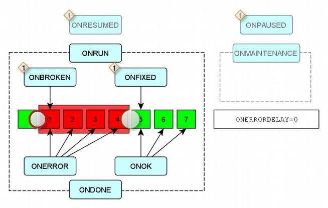

A good set of options to relay information on state changes, or each time. ONBROKEN only get's called once, ONERROR multiple times, until it is fixed..

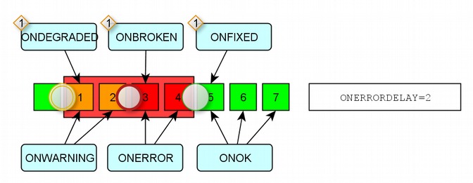

The "yeah, the website is down until you have 2 measurements of down..." means I allow for ONDEGRADED

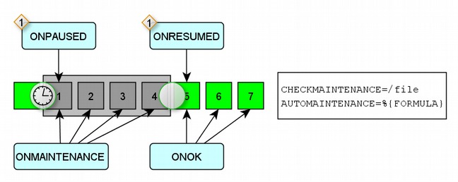

Of course, there are maintenance things, like looking for a if-this-file-exists-we-do-not-escalate (unless this file is older than xxx, then delete it and just monitor), or calculating weekends.
The thing I am proud of adding is decay. The first few minutes an error is important, but if it's down for a day... meh, do not propagate the error each cycle, instead, just send an hourly reminder (just in case the event is closed instead of increasing the duplicate counter in a monitoring DB).
This way, the monitoring does not overload the central server with monitoring events, but still runs locally each cycle, so it is able to react fast.
