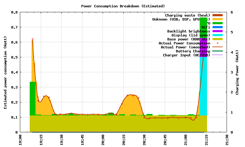

I've found a way to save a bit more power in lid-close state:
The "middle mountain" is me issuing some register changes through serial.
Stay tuned for a firmware update. Hopefully it doesn't break anything..
Cool! Looks like you got the consumption below 0.1W -- that probably adds a day or so of standby time.

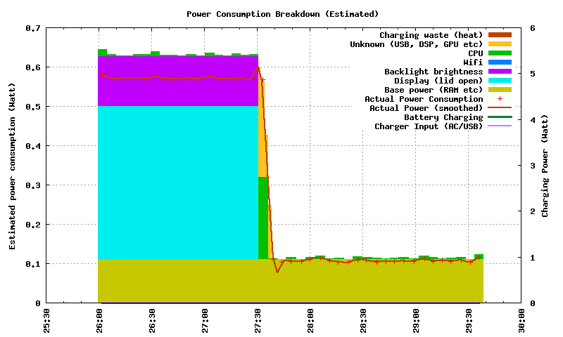

On unrelated note, one interesting thing is that my CC unit seems to be really good at power saving:
It has one of the sample screens, not the ones used in mass production.

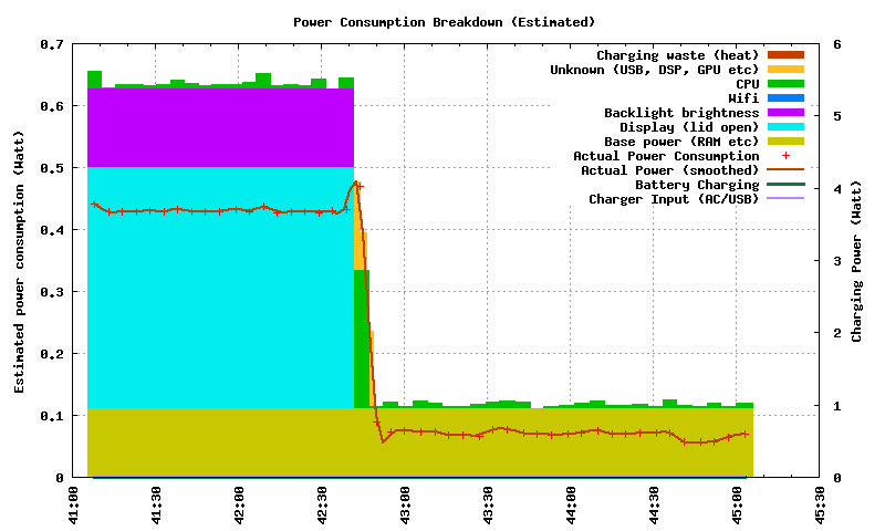

For comparison, here is my 1GHz:
It also seems to be drawing more than the last time I did measurements. Maybe it's because the battery is fully charged now and the voltage from it is higher?
Oh, nice that there's an easier model check now.
I should probably make power breakdown graph in mA, not in mW, since everything probably draws its current regardless of voltage.
I should probably also take the indicator leds into account. They consume a noticeable amount of power.
That's not really true, from my observations mA values tend to increase as the battery discharges, so it should be correct now.
