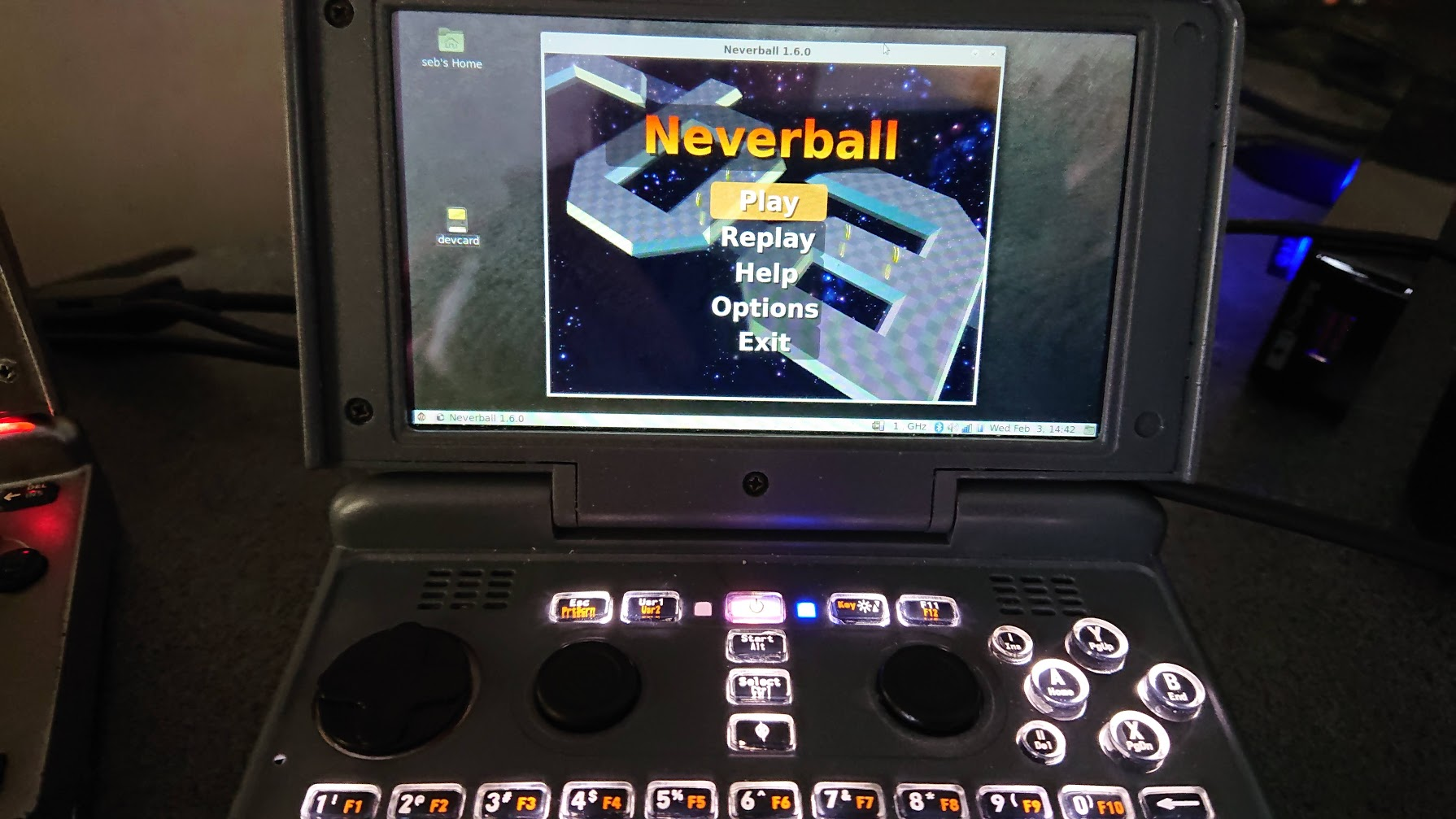

For the fun, another game, with the same methos, running smoothly with default settings.

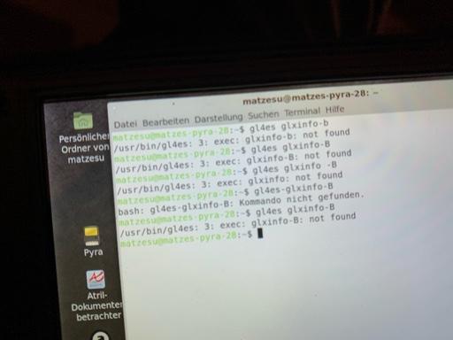

Do i write LID Library Path or is this just the Placeholder for my Library?
Just boot up Pyra, and Copy and Paste your Code in my Terminal?

In the Pyra Update from Yesterday, whe had Funkeymonkey and GL4ES as new Package, so is the Build Comand still valid?
And when Fullscreen shouldnd work, why is then Drastik allready Fullscreen?

you can try to just use
Code:
gl4es glxinfo -B
then, to see if the renderer is gl4es or mesa/llvmpipe
The Fullscreen bug is only with SDL 1.2, other stuff can works fullscreen depending on how they switch to it (like SDL2)

The third invocation of the command looked correct to me. The -B is an argument to the program named glxinfo, so spaces are needed. And glxinfo is passed as an argument as the program for gl4es to run, so that needs a space as well.
Under Archlinux glxinfo comes in a package names mesa-demos. I don't know what the equivalent for debian is.
