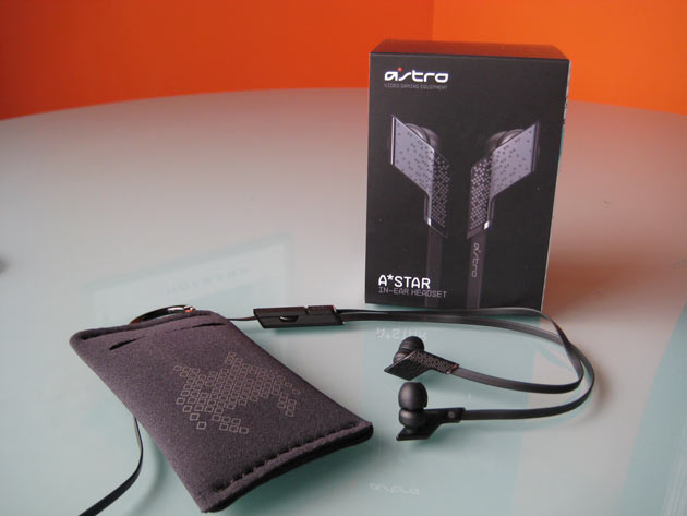

That is not true. Astro is a big name brand, and I gave you that example. They are the largest brand in eSports right now, and owned by Skullcandy, another large brand.

I had never head of Astro before.
The headset you stated is a PC gaming headset with a stand-alone amplifier. They use separate mic an headphone jacks - for which you would still require an adapter to use. They weigh more than the Pyra will.
Those are NOT off-the-shelf readily available name brand portable headsets with microphones.
You have no knowledge of the subject whatsoever. The A40s use 1 standard jack, not 2, no adaptor required. The cable has a split where you can use an included adaptor to switch it to separate mic and headphone jacks, but those are not the default. The Standalone amplifier is only to allow you extra features such as dolby audio, personal voice channel for your team, mixing in MP3 player audio, easily interface with consoles, and give you more audio input sources for your headset. (such as optical and coax) I used them just the other day to call into a conference call through my cell phone. Second of all, the a*star earset is an earset and is perfect for use with cell phones:
And lastly: these headsets are readily available off the shelf. They sell Astro products at Best Buy for heaven's sake.
-God Ginrai
You simply did not include enough information in your original statement about A40s.
This is what pops up for astar a40 in a Google search.
The A40 Audio system:
http://www.astrogaming.com/a40-audio-system/A40-AUDIO-SYSTEM-ASTRO.html?dwvar_A40-AUDIO-SYSTEM-ASTRO_color=White#start=1
I looked for a*star a40 and astar a40 on the BestBuy website and could not find anything that looks remotely like your pictured unit.

After more searching I found these which appear to be what you have:
http://www.amazon.com/ASTRO-Gaming-Star-ear-Headset/dp/B005EZ09V6
They are NOT A40s. They are also, apparently, discontinued.
I WAS able to find the gigantic cans for PC gaming at BestBuy.com, however those are NOT appropriate for this use.

No, once again, you are not reading what I said:
But I can say that my Astro A40s and my a*star headsets all use the original standard.
My point is that you are wrong about the A40s and you are also wrong about the a*star earsets. All you are doing is looking at pictures you found in google and throwing together poorly crafted arguments based on them. Take a hint from thatgui and actually do some research before you try to talk like you understand what I am talking about.
