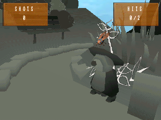

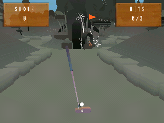

It looks like I'm the only one who can fend off the alien invasion.
Some excellent images form Kurt! Finally, the colors are correct and expected :lol:

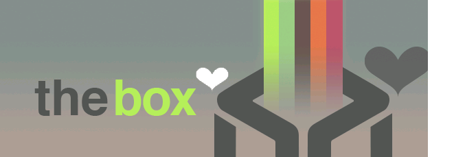

You start with an image, PNG perhaps. As I understand it, if you pretty stick a PNG into a Wiz, it it’s graphics processor will do its darndest to show it on the screen ... but that means that it will have to convert it into 16bit image (different from 16bit per pixel, or 8bit per pixel in Photoshop).
This causes unpredictable results that usually do not satisfy (though I did have a moment recently where I discovered I liked the converted image more than the source). As a visual designer, we want as much control over the image as absolutely possible.
Therefor, previewing the possible results during the production process is totally invaluable. Before this post, I linked to an excellent piece of software that allowed myself to convert/encode a source PNG image into compatible arrangements of 16bits and preview the various results in a PNG before exporting into the final Wiz compatible file (that retained the correct bit information).
Below, I will detail these different arrangements and their trade-offs so artists can be better informed as to how their texture work will/might be mangled when they stick it on a Wiz :P
The source PNG. Beautiful. Features smooth gradients and an alpha channel. The right side alpha is a smooth transition. The heart’s alpha edge is nicely anti-aliased. If only this is what we could keep. Unfortunately, we have to make sacrifices.

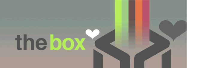

Encoding at 4-4-4-4.
Check out those gradients. Banding and very horrible dithering. The only benefit to this encoding is it gives you relatively smooth alphas. This can be a strong selling point, hard edged, aliased alpha edges can be very ugly and often produce the dreaded “white halos”. This encoding relieves you of that problem.

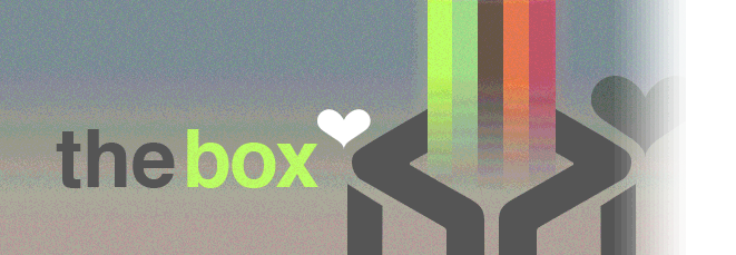

Encoding at 5-5-5-1.
Alright, those colors are not longer scaring away children. Banding is visible, but it isn’t going to kill anyone. The problem is now the alpha. The heart on the left does have an alpha, but the edges are rough. Also, note the right side, there is an alpha there, but the edge was cut off hard. There is no gradual fade. Remember, this is also the type of encoding that creates white halos!

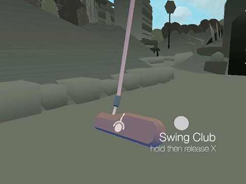

Here is my camera proposal I sent to Kurt. Note, this is just a proposal. It does demonstrate how we are imagining a fairly UI free system for swinging the golf club. I'd guess that this method is perhaps more immersive for the player then if we had lines and gauges everywhere.
I'd love to hear your thoughts!
*image links to the video on Vimeo. Please click :lol:
seems to be very intuitive! i also like the explanation, that could turn out in some nice tutorial :)
one suggestion: shoulder buttons are a bit pain IMO, could you use A/B on the button side to rotate the camera? i assume it's only rotating around one axis, not more degrees? then there is still the X button available to swing the club.
Yeah, I don't see why that can't be considered ... perhaps even both! The goal is for the controls to be as non-confusing as possible ... I can even imagine the additional Camera movement with the Shoulder buttons (A/B buttons) to be a bit overwhelming initially. The again, this audience is nothing if not technically adept :)
If this game were to go really mainstream for some bizarro reason ... I'd probably turn these more "advanced" controls into an option one must enable to use.
I would say, that in the first level, you couldn't use rotating camera, and that option would be revealed at level two, assuming that first two levels would be tutorial levels. I like the design of the white text on a gray background, so it would be cool to have the text on first levels(like in the video), and even when you finish the level, you would see the statistics in the same style. Also, I would lik to see some levels with special stuff, such as bumpers (shoots the ball horizontally), jumpers (shoots the ball vertically).
