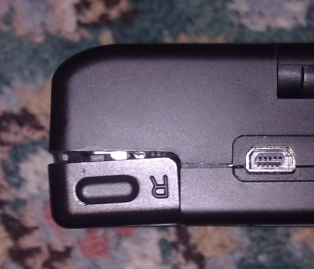

Ok this has happened pretty recently. Actually it happened today! What the problem is that my openpandora is intermittently starting up or not powering up at all - battery or with power/charger unit. Sometimes it will power up but only briefly, other times not at all and remains lifeless.

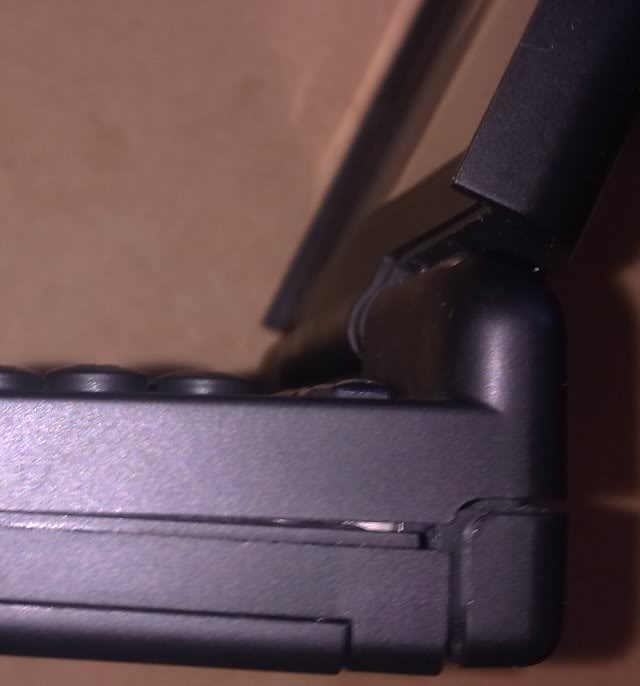

One other thing I've noticed however (picture attached) is that as of today and I've just seen this right now - at the top right of the pandora a small gap has appeared - almost as if the two pieces of plastic that make the pandoras' case have pulled apart slightly. I've not tried to open the pandora up myself and I've not dropped or banged it, just noticed this as it has not been powering up.
The right button (left and right gaming buttons at the top of the pandora) has become quite loose now , it always was a little loose but ok though it does look like it is drooping down more than it used to.

Does the screw holding the corner that is separating seem to be loose? On the face of it, if it seems 'tight' and the case is still parting, it could be that it has actually pulled it's mounting point off the upper half? That'd be the worst case of over-tightening so far.
I remember when there was all the trouble with the shoulder buttons that the team said that they realized that a lot of the screws they had were all different lengths and that might be why yours Pandora is separated there the screw being to long.

If the batter does not seem to be fitting, it is not unheard of to fold a tissue or something and stick it in under the lid to help hold it in place more. A lot of electronics have a little piece of foam glued onto the cover to serve this purpose, but I guess they either didn't think it would be a problem (and for the most part it isn't) or didn't consider it at all.
Tempel said:
Weird charging issues, and the case has started to push apart? I'm getting flashbacks to this. Does your battery look okay?
This is the first thing I thought of after looking at the pics with the understanding that it hadn't been dropped. Please take pics of the two side by side, as I'm sure this will help out others in the future as well.
I don't have my Pandora yet, but if the battery fits very tightly inside the case, any small amount of force will try to find the weakest link to relieve the stress, as with any kind of strong internal pressure.
