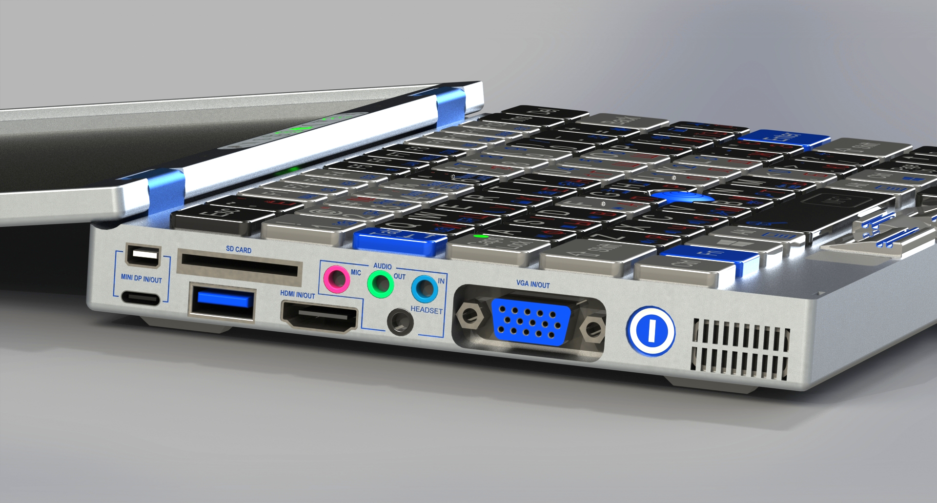

That thing would either need a lot more thickness or magic to fit anything close to that number of ports...It would be a cool concept, but the MicroPC is probably about as close as he's going to get for now.
I suspect it'd need to have seriously low keyboard travel to fit all of those ports on the side.
In his post he doesn't indicate that he has a keyboard switch technology in mind, so add whatever keyboard tech you imagine to the thickness you see.
If you reduce the thickness of the keycap by 1/2, you'd get ca. 2mm for key-travel -- plenty for a bubble-dome clicky switch. Or one could try these very-low profile mechanical keys, but suffer an added ~5-8mm to the thickness.
Also the 230mm wide keyboard is /just/ in that netbook zone where touch typing starts to become feasible. I'd prefer 250mm but that would make it too big for some applications.
If I had my druthers, the keyboard itself would be part of a screw-on plate. A handful of keyboard types would be offered, each with identical connector, but the controller would allow for alternate layouts. To accomodate the differing keyswitch heights, just make the monitor hinge swappable with one designed for the higher keyboard, or make one that is adjustable vertically. A clip or screw-on shroud around the display cut to correct depth would then form the seal between display edge and device body.
[EDIT]We could get even wilder with that! The screw/latch-on keyboard idea would allow for extra-wide keyboards that extend up to a couple of cm over the sides of the device. The extrawide wouldn't obstruct connectors - probably - and the matching snap/screw-on shroud for the lid could have extended width and thus cover the keyboard with lid closed!
It really depends on what ports look on the inside. I can imagine the VGA port, for e.g., to have essentially no depth within the case behind the actual connector; just enough to affix a metal mounting plate. He claims to have 3D sketches where parts fit, but I didn't see a link to them.

Well yeah ible, but the more I think of it, the more I think this device is straddling two different physical use-cases, and suffering as a result.
There's the server-admin and tech role where compact bag-ability is very helpful but pocketeability is not so important. The typical typing surface is a desk somewhere. For this, his proposed 230mm keyboard looks to me too cramped for longer text-entry sessions - even shell use - fairly slow and/or error prone.
Make the keyboards swappable, and you can offer an extended one with, say 250mm and 96% of the pitch (right word?) of a regular keyboard.
In my experince, most kinds of D-sub sockets have about the same behind the plate as in front of it. They usually have sheared tubes cut at an angle so that you can drop wires in easily and get at them to solder them in place, although maybe there's newer styles these days more compatible with pick and place machines, but even then I can only really imagine them making stepped leads that lead down to a level PCB that will need to fan out to at least the height of the socket unless they do something really weird. They've still got to fit those 15 pads somewhere.
Still, the thing that looked closest to the keyboard to me was that SD slot. Those tend to only have a small bump where the leads come out, and that's on the bottom anyway. But it's still a hard metal cage stuck inside the typical throw of a tablet keyboard I think.

Yeah, I've been trying to find out what the heck is the deal with them putting power buttons only on the keyboard face of any sort of clamshell device. Any of these devices could be happily used as desktop replacements with everything plugged in and the screen closed, except for the fact that the power button requires you to open it, then close it again after it boots up. It mystifies me. It makes more sense that the power button could just be seated on the side like this image. I mean, this number of ports is a little bit excessive but it illustrates a good point.
