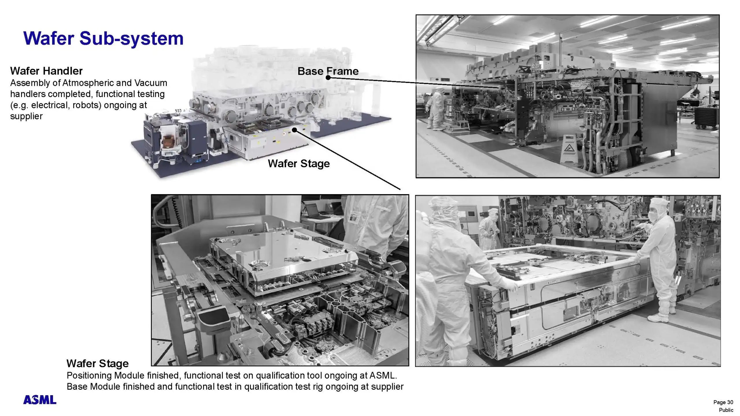

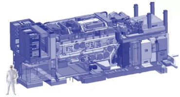

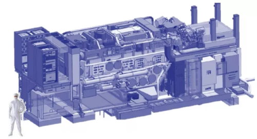

Someone was so friendly to invite me to have a look in the joint lab from imec and ASML in Veldhoven (Netherlands). As to ASML policy it's no allowed to take pictures on their premise, so I'll try to convey the visit with some pictures I found online.
The lab contains all kinds of equipment including the latest-greatest High-NA system the EXE:5000. This system is still being assembled so it wasn't looking like the fancy images with outside covers on them, but it's actually nice to see the insides. It looks almost like one big sports engine. Obviously you'll need to suit up in a bunny suit to enter the cleanroom. The was a separate metrology room with some tooling to do metrology (measurements). The EXE:5000 is planned to be released in 2025 if I'm correct, and I think the first one is going to Intel.
How the system looks like when fully assembled (it's impressively big with fancy CNC manufactured shiny looking metal parts):

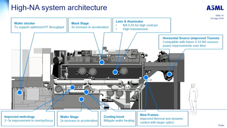

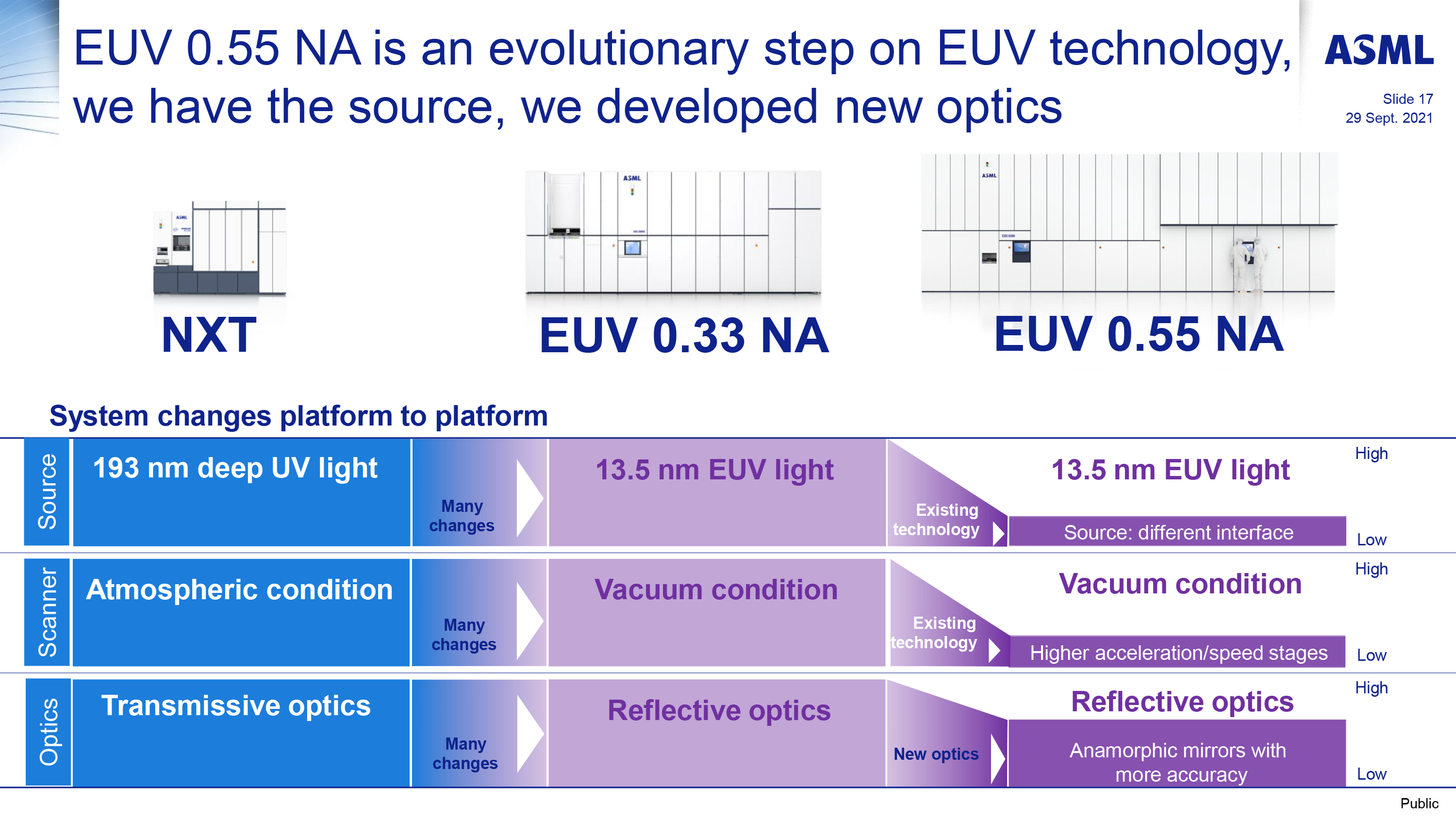

It appears there are actually slides online including ones showing some actual photos:
