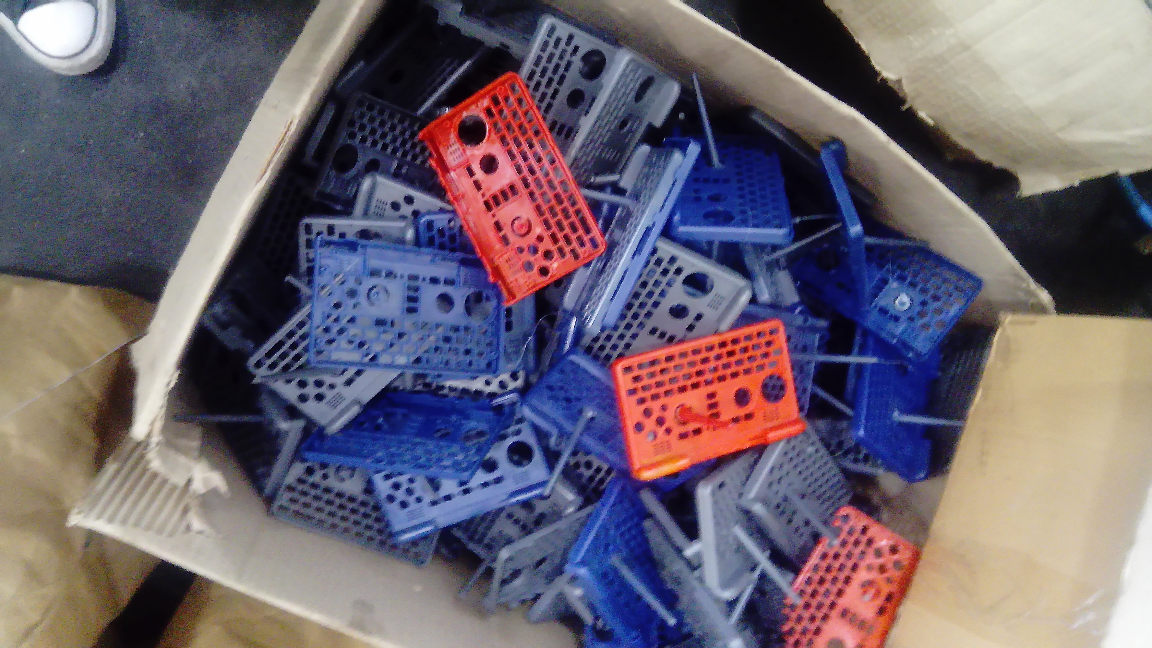

As i sayed in the past before making the pictures i am not very good with photos as ED is :) . Pictures are a bit bright and doesnt show the correct color potentional. THE BLACK IS BLACK :) and not a very dark blue, the grey is dark grey ,and the blue is a dark blue one .So be patient and wait for ED to get the items :) . Also i am moving forward making some more improvments in the Keyboard mold cause there were a lot of issues with that one and had fixed almost all of them .Its kinda hard to explain but i will try my best. To have better quality and faster production an item that has a design like the Keyboard mold you need to give the maximum ''ironing'' (ironing = the presure you use in the injection mold when is clossed for the plastic injection ) but when that happens it brakes in the weekest spot . Dont miss understand that the items that ED has and what i am sending are correctly fine.But the production will be very slow and and might throw some items away. To avoid all that we will do some modifications in the mold that i cannot explain at the momment without pictures and finish with fixes . In the pictures you can see the week spot and all the items that we are throwing away.

That's probably the reason it took FA 5 months to produce 100 transparent cases... with only two machines and other customers who also want to receive their stuff, the slow production caused by the issues with the mold slowed things down even more.
is it possible to recycle these failed cases? maybe shred them and reuse?

They wouldnt just put the Case Parts that cant be use in the "Bin", as its a European Plastic Company, they put it maybe in the Recycle Container, or have a Shredder to make new Mould Material..
A hand full of these Pellets arend expensive, but if you see the big amounts of Cases they made, i think there will be a lot of Plastic that needs to be reused..
... Except they have colors in them, makes the re-use not that easy for just anything :-/
cannot be reusable in this kind of items like Pyra ,and yeah since there is color inside its near to impossible to use it again .In other cases we do that but not in items like pyra. First of all to have a good production you need to have molds that you dont throw away items :p . I will fix that for sure cause is the correct way to move forward .
