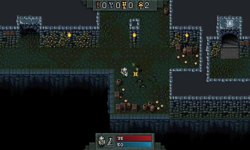

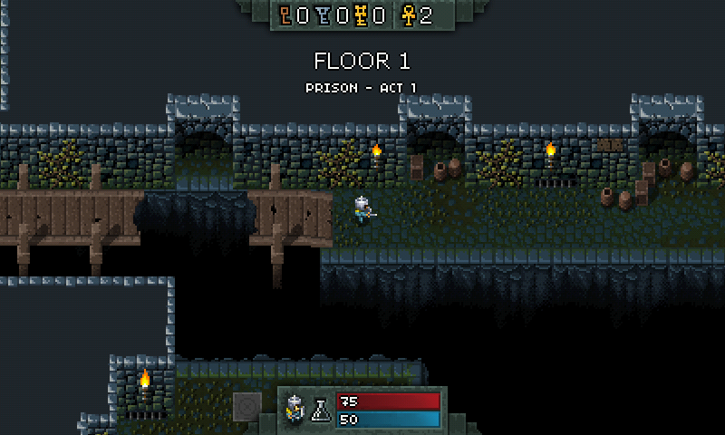

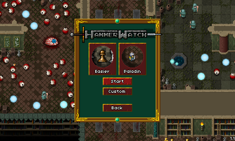

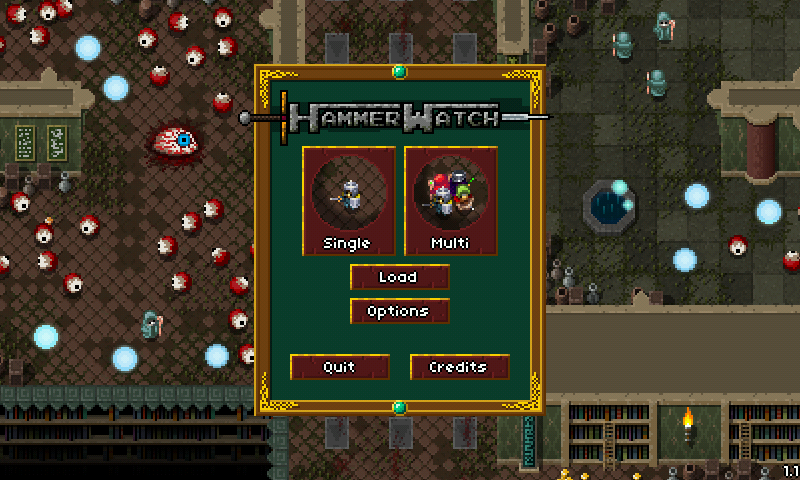

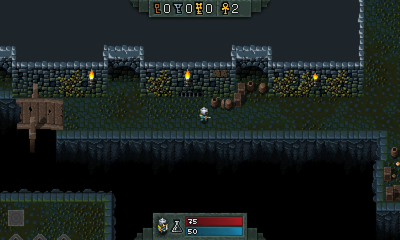

Here is the beta thread for the Hammerwatch Launcher.
For this, you'll need Hammerwatch full game, and the Mono Runtime PND
The Launcher is here.
This game needs a lot of memory, so a SwapFile (of 512M) is mandatory.
v1.10 and v1.20 are supported (they used OpenTK for OpenGL graphics), but newer 1.22 used SDL2-CS and has trouble to launch. The last version of the launcher should support it but it's untested. Please try and report.
