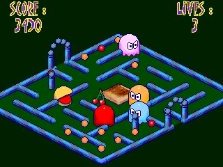

bigtrouble77 posted on Apr 7 2006 at 09:18 PM said:
If anyone has experience with isometric systems I'd love to ask some questions here.
I messed around with isometric views. I uploaded a little isometric pacman type game for the GP32 to the archives a couple of months ago. Sadly I lost the source (same story as with icurafu) but it is fairly simple. If I can help let me know.
Ghosts on Toast
