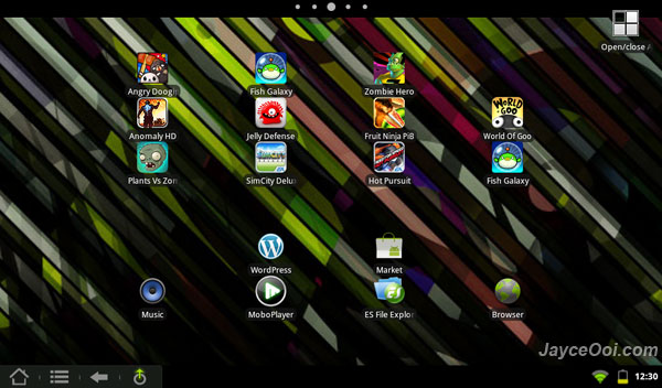

Since we lack proper Home/Back buttons etc. It maybe worth setting it in 'Tablet Mode' basically you get permanent soft keys like the picture below.
Not sure how exactly this is achieved
