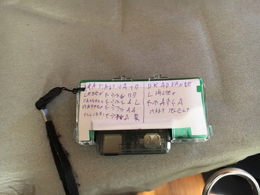

If whe get the Transparent Case, whe could make my New Patent "Cheatspicker " and place this between Batterie and Batteriecover
This ditnt work whit Pandora because you cant see the Cheat s under the Batteriecover as its not transparent
Gesendet von iPhone mit Tapatalk
