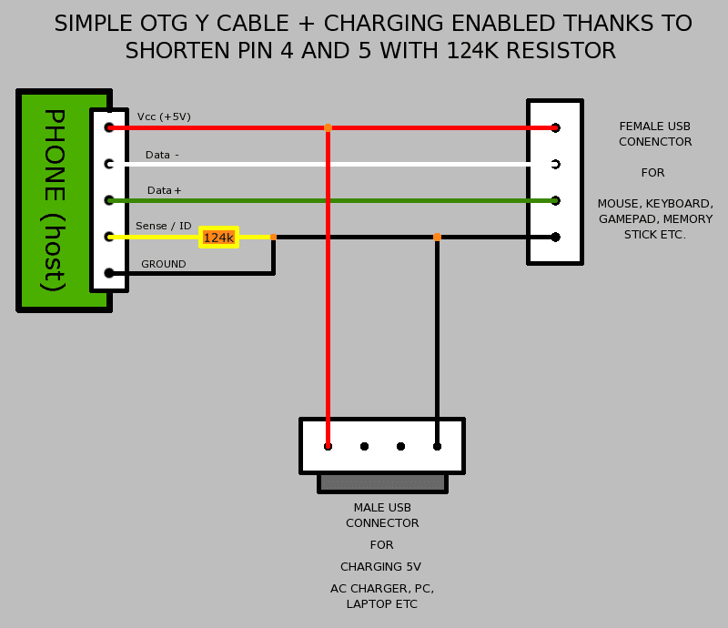

To be honest, Who really needs that? If it would have been easier to do 1 chargable port, why not keeping it that simple?We've got two MicroUSB ports and want to be able to use both for charging. Sounds easy? Well, yes, at first. But there's no charger chip out there that actually supports TWO USB ports. Addtionally to that, USB needs to negotiate the maximum allowed current... and the USB protocol needs to work as well. No easy task, and a pure custom solution.

I do. Pretty much anyone who wants to be able to both power the device AND utilize the full capabilities of the USB 3.0 OTG port at the same time does. This is a BIG feature for many of us.To be honest, Who really needs that? If it would have been easier to do 1 chargable port, why not keeping it that simple?

Wouldn't this also be solved by having only the other port accept power, and have the OTG port not support power input?I do. Pretty much anyone who wants to be able to both power the device AND utilize the full capabilities of the USB 3.0 OTG port at the same time does. This is a BIG feature for many of us.

Why not using a dedicated charging jack instead? (to late, I knowI do. Pretty much anyone who wants to be able to both power the device AND utilize the full capabilities of the USB 3.0 OTG port at the same time does. This is a BIG feature for many of us.

Why not using a dedicated charging jack instead? (to late, I know) Or the other free USB ports that can't charge? ...Or an simple USB-Hub?

Actually, for that the USB consortium invented the Accessory Charging Adapter, which sits between the OTG port and any attachment, and additionally has a charger port.Pretty much anyone who wants to be able to both power the device AND utilize the full capabilities of the USB 3.0 OTG port at the same time does. This is a BIG feature for many of us.
