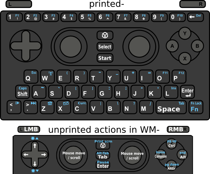

Here is another, similar to kagato's most recent and preferred layout.
This one has Fn keys a little closer to normal position then kagato's.
There are extra media buttons at the expense of a single alternate currency. From left to right they are: play/pause, skip track, launch browser, launch email. At this point we have all keys on a standard qwerty-us keyboard so I think its acceptable to have these keys.

Actually, this was my last layout:
(number and top row Fn swapped)
http://studiokagato.com/downloads/pandora/pandora_keyboard_v3_plain.png
I like almost everything about it, but lack of Ctrl and Alt keys is a showstopper to me. Unless there is some way around it (like "orange keys" proposed by Cosurgi)?
In all Kagato's layouts Alt and Ctrl are on shoulder buttons L & R. The labels "Alt" and "Ctrl" are not printed on them, because shoulder buttons are behind (on the back of the case behind and below of the lid). That was the major point of that last voting:
  • "Alt" & "Ctrl" on shoulder buttons as some thumb-typers find more comfortable, AND ".", "," are base keys.
  • "Alt" & "Ctrl" are base keys which is more similar to common keyboards AND ".", "," are Fn keys.

Hi Kagato! I guess that !@#$%^&*()-= chars are better on QWERTYUIOP keys, as in previous versions. Actually, It's good idea, haven't standard nonshifted keys as shifted on Pandora. But I vote for drop out others currency symbols (EUR, GPB and YEN).
Ctrl and Alt are mapped to L & R shoulder buttons.
They were labelled on the original diagram but not on the last revision... I guess I have to make another image <_<
Yeah, I still prefer that placement for the punctuation for ease of typing. But to make good use of the number keys requires doing nonstandard things with Shift, and in hindsight that could cause some problems for ported software. In this layout, all symbols are either a Fn, or the same Shift as a standard keyboard. Not as good ergonomically, but better for software.
(Oh. I see that was supposed to be strikeout text. Never mind then :))
They're not essential, and could be accessed by AltGr; but that leaves three empty spots for Fn keys. Only a few blanks would look odd, and waste useful space. By including them it helps indicate the device caters to international users, and even if you don't speak another language you might sometimes need to refer to foreign currency :)
But seriously, if you can think of three functions more useful to more people than currency, I'm open to suggestions.
