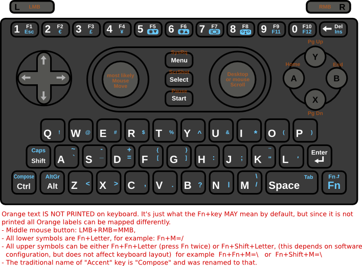

Thanks for your comments. So I am updating this layout:
- Change label "Fn lock" to "Fn ↗". It will depend on software configuration if it's *tap*tap* (press twice Fn) or Shift-Fn. Regardless of that the same thing is printed on the keys.
- I looked, but I could not find any place to move '+' & '-'. I could swap '+' with '|' but then '-' would stay there alone, and in the end it might be harder to find (becasue '+' should stay close to '-' IMO).
Caine said:
Cosurgi, the Fn+shift approach is very interesting. However, in my opinion, this would be easier if Fn and shift were next to eachother such that you can hit both with a single thumb and use the other hand to strike the required key (although, it might also increase the amount of misspresses).
@Caine yes, would be nice to have shift close to Fn, but it's only 6 rarely used symbols. I thought for a while about swapping Fn with Ctrl. But I didn't like it, because then pressing Ctrl-Alt combos will become more difficult. And although it's impossible for me to know, I guess that Ctrl-Alt combos will be more frequently used than ~-+{}\. Besides now, you can use also Fn+Fn (press twice) solution, instead of Shift+Fn.
Hm, in fact I'm looking at it now, swapped, and It's not that really bad. You can press Fn-Shift and Fn-AltGr with single keypress. While pressing "Compose" (that's a traditional name for "Accent") still has the same difficulty as before. Not that bad at all...

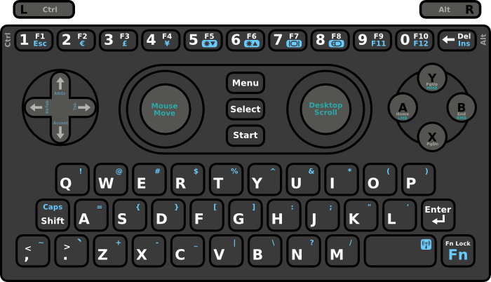

Ok, so here are two revised versions:
SVG SOURCE
SVG SOURCE
IceBerg303 said:
cosurgi said:
That's a yet another variation:
1. All labels that I consider unnecessary are removed.
2. Mark Ctrl & Alt because I'll never remember which one is on the left and which on the right. (but I guess that I'll need to put a sticker there, becuase it requires printing on the case)
3. Move all other labels onto the buttons. They become really small, uh.
4. Who needs "Space" on space?
5. Didn't rearrange any symbols - they are the same is in Kagato's final proposal.
This layout would be very nice and most useful.
But isn't the simplistic layout already set in stone?
Thanks IceBerg303, but actually I wanted to withdraw this one from the poll... Because those changes are just tiny details and everything else is exactly the same as kagato final revision. Those details (whther to print "Space" on space) are more up to devs. The original idea to print Alt and Ctrl on the case is nice, however.
If you want me to inlude that proposal in the poll, you are welcome to resubmit it as your own :) And I will put it as another poll choice in the voting. Just let me know about that, before I'll make that poll thread, probably somewhere around tomorrow.
There is not enough difference to resubmit this one. bothe are very good, I like them much more than what we've been seeing on the mock up pandora.
I was afraid I was going to have to carry a roll up keyboard with me, but if we get something this nice I will be ecstatic.
