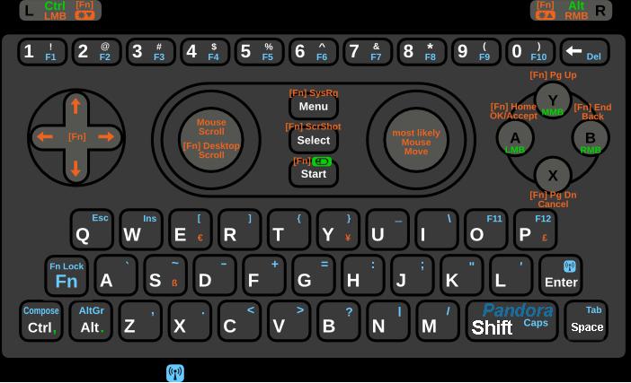

Grench said:
OK, so I'm not a graphic artist.
I gave it some serious thought as I put this together. I didn't change your merged view much.
Having Fn and Fn lock are critical. I can think of lots of games that interactively use numeric keys (pretty much every FPS as gun selection), several that use function keys (Neverwinter Nights), but few that use both the function and numeric at the same time as their 'important' buttons. I.e. important to interactive gameplay and not just save/restore and the like.
So, having the top row switch numeric/function and stay that way until told to do otherwise - highly important.
However, I would like to see a way to split the Fn reaction between the numeric and alpha portions of the board. The reason for this is that games that use mostly function keys still use letters on the keyboard. So, to do this, I propose that the Fn key work as...
Fn momentary = switch everything to Fn shifted or back.
Fn held + Shift = switch only the numerics and O and P to F1 through F12. Fn held + Shift undoes this.
I printed out your keyboard. The Fn key down on the bottom right is going to get hit a lot unintentionally. The space bar, since it is most often used as activate/interact with/jump wouldn't be as annoying in accidental activation compared to a button that changes the interface mapping.
I rearranged 3 keys in the end. Yes, it makes the shift big. The Pandora is a big shift from everything else out there, so why not.
I'd really like to get the Fn key out of the corner regardless. Thank you for being open to input!
imo that is the worst layout i have seen... how can i make the letter "M" as a capitol? My thumbs are not that big. The shift key should be easily accessable on both thumbs. how is fn lock useful?
edit: wait I just noticed something, it is like this on all the layouts... WTF??? how the hell are we going to capitalize something without the shift key being on both of our thumbs??? The shift key should either be the shoulder buttons or should be on accessable BY BOTH THUMBS! My thumbs can not reach across the whole board! please look at the sidekick III layout. I still do not see how fn lock is useful, it should be replaced by shift. ctrl should be on the left side of the keyboard and alt should be on the right. space is weird... I have to stop, press space and then press a key unlike an actually keyboard. On a keyboard you are ready to press a button right after you hit space because one of your fingers is already hovering above the key. Im just gonna make my own layout
If we have another poll it should be on concepts not anyone's layout. To be honest I don't think that many people know what they where voting on or took the time to dissect mapping.
I would love input from the devs on anything that happened in this or the last thread. The number of votes, posts and threads show that this is still one of the most important subjects we don't know enough about.
About accidentally hitting the two bottom corner buttons- I don't think it will be a problem. When I tried the approximate placement of the buttons on a DS, they managed to be relatively easy to hit and still far from my palms. While game this will not be a problem because keyboard will probably not have input.
"edit: wait I just noticed something it is like this on all the layouts... WTF??? how the hell are we going to capitalize something without the shift key being on both of our thumbs??? The shift key should either be the shoulder buttons or should be on accessable BY BOTH THUMBS! My thumbs can not reach across the whole board! please look at the sidekick III layout. I still do not see how fn lock is useful, it should be replace by shift."
Sticky keys......
btw I don't like that one either (no offense).
polkunus said:
The shift key should either be the shoulder buttons or should be on accessable BY BOTH THUMBS! My thumbs can not reach across the whole board! please look at the sidekick III layout. I still do not see how fn lock is useful, it should be replaced by shift. ctrl should be on the left side of the keyboard and alt should be on the right. space should be the biggest button on the right.
Heh, there are simply not enough keys for that. You are welcome to submit your own design, which does not require adding more keys. Hardware is fixed. We are only debating here about what to print on the keyboard.
And of course, like with all handhelds - you can use sticky keys mode. This solves your problem in 100%.

Actually, this was my last layout:
(number and top row Fn swapped)
I now think not using Shift for anything Shift isn't normally used for is a good idea, so I'm starting to prefer this.
The numkey punctuation symbols aren't the most frequently used, so I guess the extra reach isn't such a problem.
mkinzler said:
I wonder if it is a good idea having Fn and Fn Lock on the same key
It's pretty normal for thumb keyboards. All the devices I've had worked that way.
Press Fn twice for Fn lock, Shift twice (or Fn Shift) for Caps lock. Press once more to unlock.
