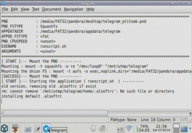

@ingoreis : can you try changing the .alsoftrc in appdata/telegram and switch from alsa to oss?

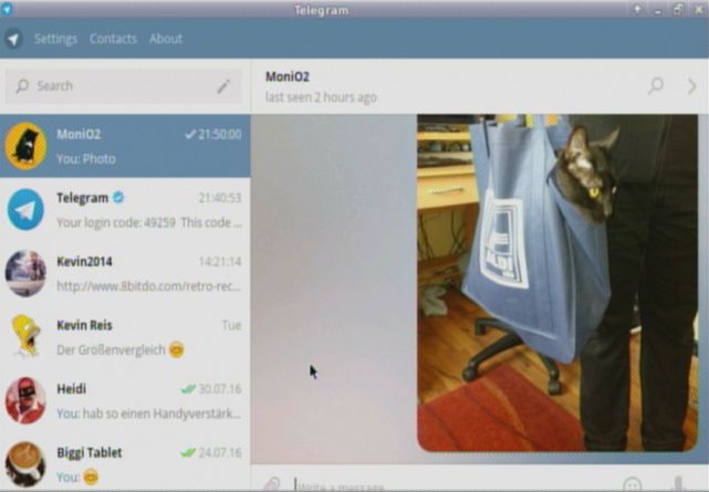

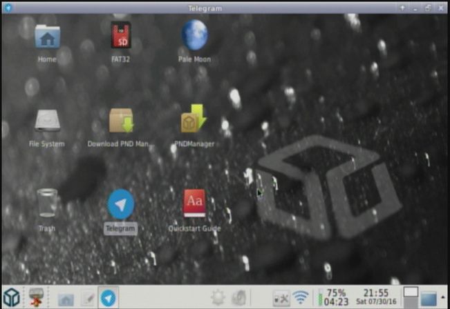

I have updated the pnd (still same link).
The writing to the NAND should be fixed.
I tried something for the Window size, so it should be ok now (if not, check the settings and ensure the GUI is @100% and not more).
This Version is nearly perfect ;)
Little Issues:
- A right Mouse Klick in this Windows crash Telegram
- The Window Size is nearly perfect...
...when i autohide thePanel...
....see the Screenshot:
Maybe you can decrase the Window little bit more that we dont must hide the Panel? ;)

Code:
cd /mnt/utmp/telegram
OPENSSL_armcap=0 QT_XKB_CONFIG_ROOT=/usr/share/X11/xkb HOME=/mnt/utmp/telegram/home LD_LIBRARY_PATH=/mnt/utmp/telegram/lib:$LD_LIBRARY_PATH gdb ./telegram
If you are using SSH, don't forget to add DISPLAY=:0 in front the command line
4. After some seconds, gdb will be ready, so just type
Code:
r
to run it. Than try to reproduce the crash
5. When the segfault occur, nothing will happens on the telegram screen, because it will be in a "frozen" state by gdb. You need to switch to the command line window (if not using an SSH)... On it, you will see that gdb intercepted a SEGFAULT somewhere. Type
Code:
bt
to get the BackTrace. I'll need the whole gdb output here.
6. you can quit gdb, with
Code:
q
and unmount the pnd
Code:
cd $OLDPWD
/usr/pandora/script/pnd_run -p /PATH/TO/telegram.pnd -u
That's it...

This Crash with the Right Mousbutton is only on the Part of the Screen where my Cat is in the Bag.
