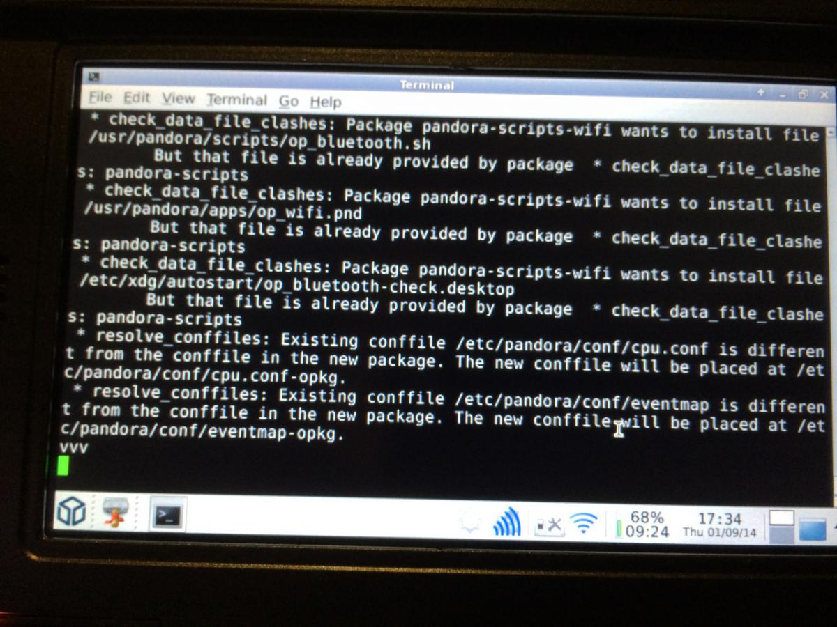

Ok I had 1.52, and I used Update Pandora OS to upgrade.
Right now my Pandora has been stuck on this screen for 45mins, wifi led is orange. Is it stuck, or has it finished? Should I restart?
EDIT: ok looks like they were logged errors.  Rebooted fine.
However where is "Enable WIFI" gone from the configbutton app on the panel in Xfce?
Argh I cannot find how to enable wifi now, no option to enable Wifi in System menu, no enable wifi in configbutton app.
mini menu, using the MM Wifi on app says starting Wifi, but no light.  Network connections has my Wifi access point SSID and settings defined.
EDIT: Ok Trying some more things in terminal.
sudo iwconfig wlan0 power off
Error for wireless request "Set Power Management" (8B2C)
         SET failed on device wlan0 : No such device.
sudo rmmod wl1251_sdio
ERROR: Module wl1251_sdio does not exist in /proc/modules
ls -l /proc/modules
nothing there!
EDIT: Time for for reflash, since upgrade killed my wifi module.
EDIT: Reflash successful, Wifi back in operation :)
