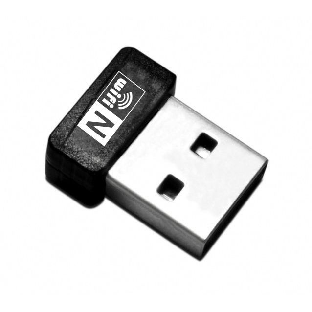

The best solution is to make a tiny camera you can plug in usb-ports.
A mix bitween these:
