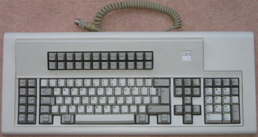

For example an F row that isnt a row, but instead 10+ and then 2 down and to the right, doesnt make sense.
'F row'? Oh, you mean the function keys? Yes, a blind or partially sighted person would have to spend a while learning the keyboard layout of either the Pandora or the Pyra, but once they have surely home key nodules help them locate the right keys to start with?
I know right!, things never been the same since they dropped the P in the function keys

thatgui because they arent springloaded keys. If you were to hit them on the side it would wobble the key rather than to hit it from centre.
On AT and XT style keyboards it used to be the G-row, which was to the left. By the F-row i mean F1 F2 F3 etc
It was a little jab at some of the other keyboard designs, which to me seem like they were done by a blind person for someone who isnt blind.
