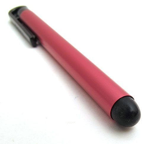

Resistive with basic multitouch: I like it! This is the best of both worlds: accuracy and support for Android gestures. No need to use a sausage stylus or greasy fingers with a diameter of 150 pixels.
Sausage Stylus? o_O

Thinkpad: Resistive is just that much more accurate, plain and simple. Capacitive is good for stuff where you have thumb-sized UI elements. Resistive is great when you need accurate positioning. Digitizers like wacom's are great when you need accurate pressure detection and positioning (but requires a special pen). Which would you say is our use case?
Shenmue: A capacitive stylus with a tip that actually somewhat represents the accuracy of the capacitive display.
