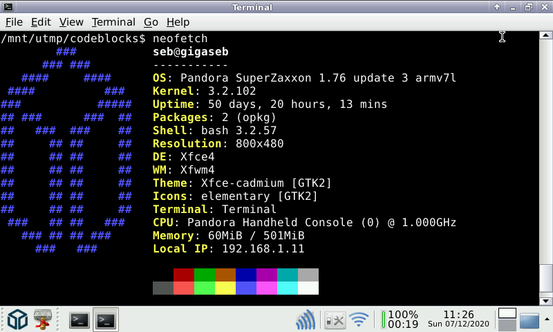

Next codeblock release will have neofetch
I'll probably try to build gcc 10 before creating the pnd. Then I'll probably push the pnd to the repo and will stop update it unless some breaking bug is found.
