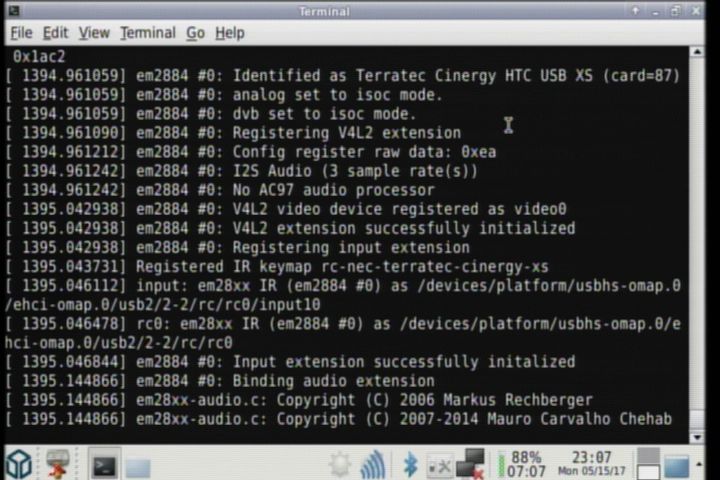

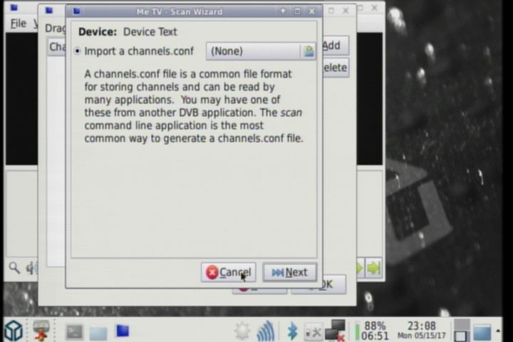

I thank you very much for creating that Me-TV PND :D
Unfortunaly it do not work with my Technisat CableStar Combo HD CI and
not with my fully registerred V4l2 Device Terratec Cinergy HTC USB XS.
Me-Tv PND should give me now the Chance to Scan the Channels by itself..but it did not.
It want a Channels.conf instead of creating the Channels.conf by itself.
My Terratec Device is fully registered as V4L2 Device video0 but its not found from this PND yet :(

I have just updated the PND, adding the missing libs.
But I odn't think that will solve the "Channels" issue. What is this "scan" command they are refering? It's not built from me-tv, is there some other package that should also be built?
Shall a command line for me-tv be created also?
The missing Files where added,the PND Runout seem to be fine now ;)
Unfortunaly this DVB USB Adapters i used..are maybe not fully registered as i thought.
This Scan Application for the Terminal is easy to install into the Pandora Zaxxon with:
Code:
sudo opkg install dvb-scan
..and even this do not find my DVB Dongles.
I must try more with Firmware Files or Drivers.
Your ME-TV PND seem to work fine.
I am Curious if i can find the right DVB Firmware Files for my rescent 2 Devices.
In Germany DVB-T is Shut off and DVB-T 2 have new Frequencies...but i still want to use it for DVB-C with Cable TV :D

Thanks for the Informations.
My Problem is that my Terratec Cinergy USB HTC XS Dongle is automatic Mounted as V4L2 Device.
..but not as DVB Device.
I tried some other Firmware Files for it but ever the Same here.
Same Problem with my Technisat DVB-C USB Combo CI Box.
When the Tuners are not registerred as DVB Device..
..then shurely can Me-Tv not find one.
Unfortunaly i got all my old working DVB-T into the Trash because no need more here in Germany for them( because DVB-T 2 changing in Germany)
I must read and try more..
..maybe with some Modprobe Things to get it work.
Do anyone other can Confirm that the Me-Tv PND is working fine?
Zaxxon does not support my rescent TV Dongles out of the Box.
