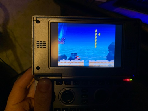

@Grench You paid a lot of money for the privilege to be among the first paying customers taking pictures. Don't waste it or ... you know ... all you describe didn't happen. ;)
I have tried to take some pictures of the screen / device. Using the flash all I see in the picture is my ugly reflection in the screen. Without flash, it is out of focus and blurry.
This is about the clearest I have been able to get of it sitting on my desktop. To do this, I turned the keyboard backlight to near off and the display backlight down to two steps above off. Camera flash is off. My overhead light is dimmed about as far as it will go. It is still overexposed with exception of the nuclear powered power button LED.
But - here you see my Pyra prototype Marble playing a Louis Armstrong song during random playback using Audacious.
I tried to take a video of it - a blurry mess. Pictures and videos really aren't my thing.
Seeing it sitting there like that, how does the hinge do/feel?
Maybe the screen would be less foggy in the picture, if the it was tilted further upwards in this situation.
Hinge feels excellent. The only 'lock point' for the hinge is at full open (flat).
If I tilt it more upwards all you are going to see is the reflection of the camera/phone and my ugly head behind it. The reflections are not bad when using it, but getting a good picture of the screen while on seems to be difficult. The 'fog' is also due to taking a still picture of an animated screen. Others seem to have a much better set up for pictures and video - I'll leave them to it.
