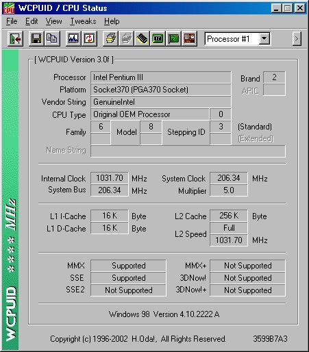

Ah the memories. Overclocking CPU's to the max, 1FSB up would crash getting into windows, back in the day everything was maxed out. I remember my old 500Mhz P3, overclocked that to 1Ghz, no PCI divider so that was running at 50Mhz, it all ran perfectly fine. Never had a CPU fry and had my PC on 24/7 with some pretty high voltages too, same went for memory and GPU's.
Ha, found an old screenshot too!
