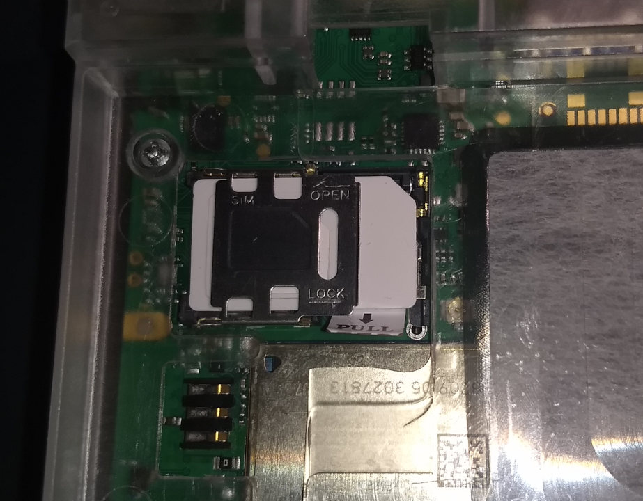

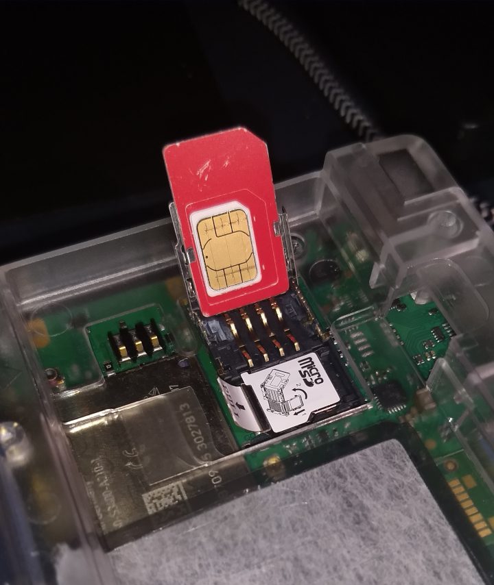

Also, there seems to be some confusion regarding the sim card. It needs the older larger sized sim.
other sized sims can be forced in there, but this is what it should look like :

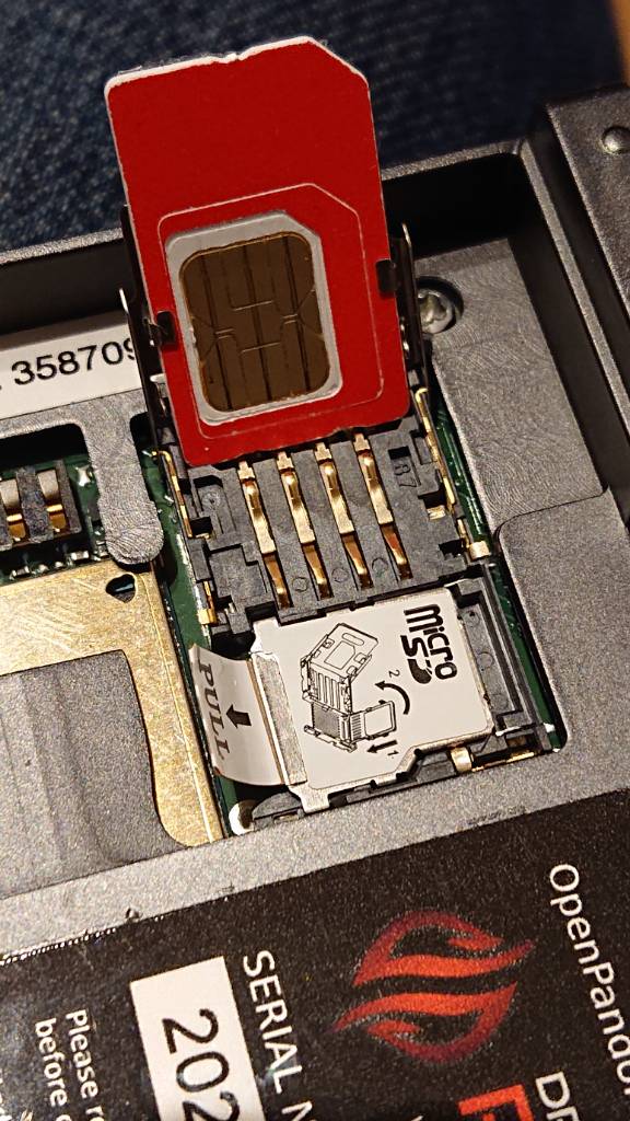

Please let me get a noob question as well.
How I get any sign of life from the 4g modem ?
lsusb shows me two devices, sometimes just one:
Standard Microsystems Corp.
Linux Foundation 2.0 root hub
Modem Manager can't find such a device connected.
So I dont need it now, but I want to ensure that it's propper connected and I can use it, whe software is smooth running.
SIM is already inserted
And yes, I choosed EU mobile edition and have an IMEI label inside.
