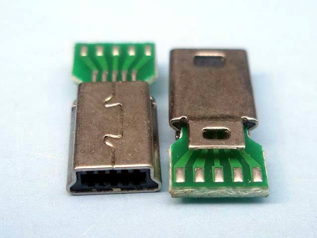

I'm fine with Mini-AB as long as the Mini-A-Adapter is included or at least available from the dagonbox shop. Finding one was a PITA, not least because of crappy descriptions and unhelpful images on online stores.
Types of USB connectors left to right (ruler in centimeters): Micro-B plug, UC-E6 proprietary (non-USB) plug, Mini-B plug, Standard-A receptacle (upside down), Standard-A plug, Standard-B plug
