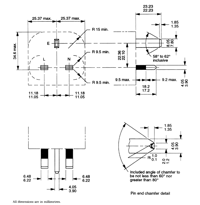

Not sure about the BS 1363 plug in that picture. Doesn't look like it has the standard 9.5mm spacing between the live/neutral pins and the edge of the plug body. Earth pin looks a little thin too.
Having two USB A sockets on the adaptor is a good idea - but check it actually can provide 3.4A without huge voltage dropouts. Also, get a competant EE to rip it open and check there aren't any design horrors (e.g 0.5mm creepage between mains live and USB GND, or simailar)
