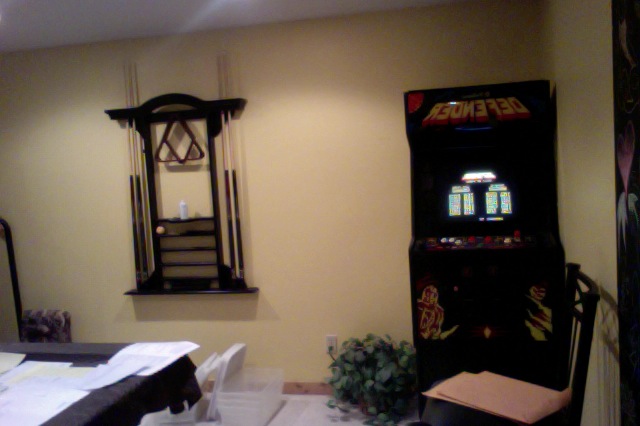

Now how do I transfer my high scores from "The real deal" to my pandora? ;)
Simple, replicate your high scoring game!
Do you own the worlds only backwards defender cab or did you shoot the pic in a mirror?
Billiards table and Defender == well done :) Thats my goal too .. got a new place with more space .. once the little rugrats grow up a bit, I'm nabbing a full size pub billiards table from a clearance auction..
