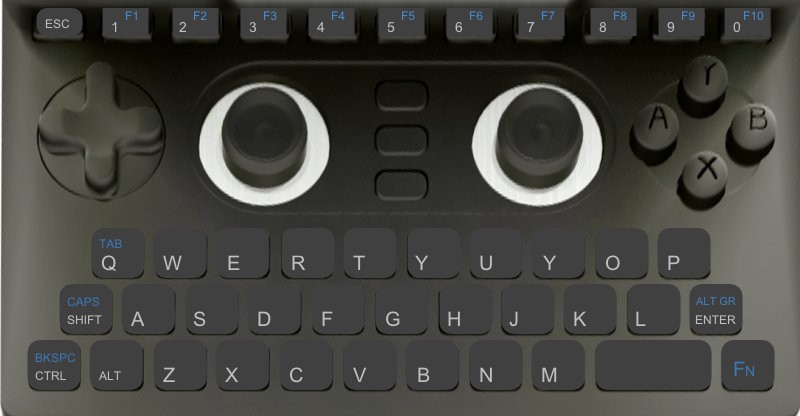

This is another layout.
I won't be adding punctuation signs, as their position vary on every language keyboard layout.
Things that change against previous keyboard layouts are the ESC and Backspace keys.
For thumb typing, the best position for backspace is the CTRL key, as it's on the opposite side to the FN key.
EDIT: Added the ALT GR label.
Thanks CoMiKe, this is actually a very nice minimalistic approach. Brings some fresh air here :) I only want to point out two small mistakes: It's impossible to press ctrl-backspace. Used to delete whole words, alt-backspace may be used also for something. Maybe in your design the best place to put backspace would be Fn+SPACE? And you missed the 'I' key ;)
On all thumb-typable keypads I've ever used, FN has always been a "sticky" key. Backspace is used far more often than Esc, and therefore should be a "white" key and reside in its natural position.

Ok, so the FN key works as a dead key (like accents on the spanish keyboard). Interesting, didn't know that.
Then, as you've discussed previously, backspace being a Fn combination is a problem, actually. As you would have to press Fn, then Bkspc, for every character you want to delete (unless you hold the backspace key, but that's inexact on most cases).

Sorry, I made some significant changes to my post that should clear all of this up.
AireTamStorm said:
Loving the simplicity and clean look of it.
Thanks, although perhaps it would be better to include punctuation signs, don't know.

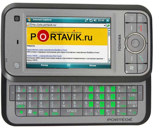

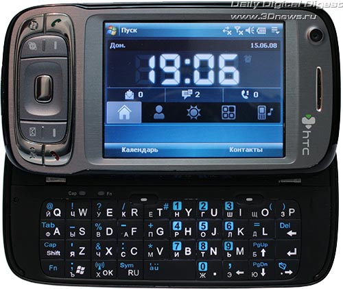

Here's a pretty good examples how to map Cyrrilic chars to the small keyboard. (I owned G900 for some time.) And that layout is pretty good.
But since we have less keys... It will be rather difficuilt.
This is another example -
Another one -
And another closer one -
And another quite strange one -
Please, NO cyrillic Letters onto the Keyboard, at least not onto the western sold Devices! I don't want such a whole bunch of extra Characters I personaly never need or use. It kills alot of the clean look.
...the blue Keypads of Pic 2 and 3 are nice by the way, I bet they are all backlit, something I will really miss onto the Pandora.
