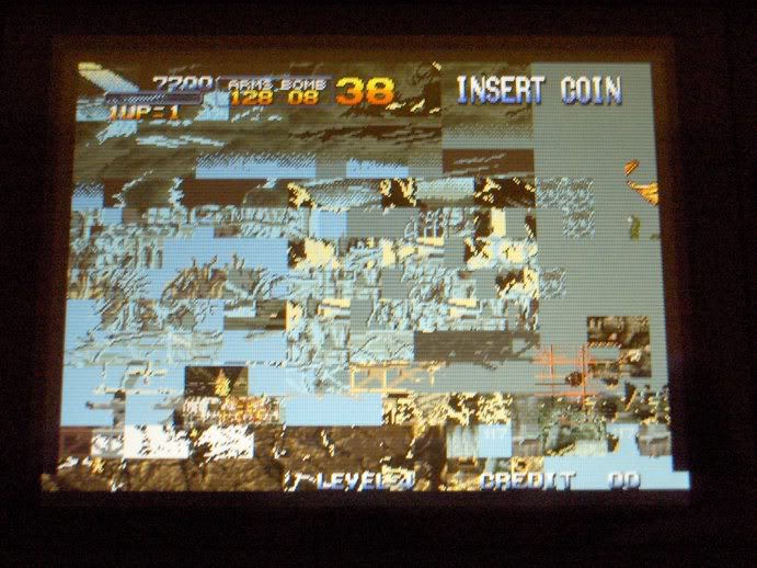

for metal slug 5 i get a screen like this after i insert a coin and push start
this is not the actual picture i took this from page2 of this thread but it looks pretty much the same. does this happen to anyone else?
Did the roms you used were decrypted?
if yes, then it's certainly the romrc that should be tuned slightly (the GFX part I think).

i did noit use the decrypted ones. but i have them, what should i do i tried replacing the roms with a decrypted one and no i just get a black screen and the thing in the back that says your score and bombs etc...
do i need to do a gfx dump with the decrypted gfx roms?
i got it :D i just beat it also, damn i love these games does anyone get sound in mslug 4 or 5 all i get is the sound it makes when i insert coin
