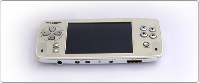

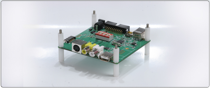

Devboard:
Homepage: http://www.gambros.co.kr/
Technical Data:
CPU : ARM11 @667MHz
RAM DDR - 128MB
NAND - 2GB
SD/MMC support
LCD : 320x480 , 3,5" 24bit TFT with touchscreen
Sound : 24bit PCM codec, 64Poly MIDI, Stereo speaker
Mic input
4 direction buttons , 8 function buttons, 5 aux buttons
Dual vibration motors
3 Axis accelerometers
OS : GPOS/Linux (Dual OS boot support)

Just knowing that it's ARM11 and 667MHz isn't much to go on. What's going to make a huge difference is whether or not it has L2 cache and how efficient the memory architecture is. The size of the L1 cache will also be a factor. Some ARM11 devices do have both 32/32KB of L1 and some amount of L2 (i.MX31 has 128KB).
Otherwise, the difference between ARM9 and ARM11 is kind of a wash. ARM11 can fold branches meaning that they're 0 cycles if predicted, vs 3 cycles for taken branches on ARM9, so decently predictable code will perform better. There's also a hardware stack which improves function call/return overhead. On the other hand, the load-use stall is 2 cycles so there'll be more stalls due to that, but the penalty for L1 misses will be a little lower because of the non-blocking cache and hit-under-miss capabilities.
The instruction set offers some more stuff too, but it's mostly pretty specialized. That is, unless this ARM11 is one of the Thumb-2 level ones.
Oh, and the ARM11 probably has VFP, so good for things that need floating point.

That split d-pad looks bad though, looks like a worse version of the PSP pad (shallower).
Also a terrible screen resolution for emulators though so it would not be great for that. Almost nothing goes evenly into 480 x 320 so just about everything would have to be scaled fractionaly in *both* directions making for some extremely ugly game graphics. 640 x 480 would have been much better.
