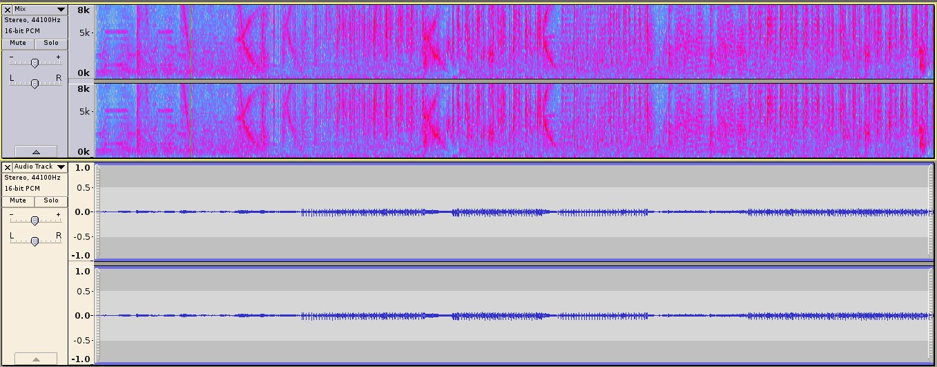

Diff between FT2clone_101.pnd and FT2clone_b6.pnd with the song "Space Debris"
Method used:
  • Use pnd_run to explicitly select the pnd to run
  • Use the save WAV file inside each FT2 to save the mod to wave. (101 too a LOT more time to convert, but maybe it was because of the SD cards, I have one pnd on each)
  • Load both stereo wav files into Audacity
  • Select only one of the stereo tracks and use the effect "invert" (which flips the sound horizontally)
  • Listen to the result. If wav's are identical, there should be silence
  • Merge both tracks (mix and render to new track)
  • Show a spectrogram for visual inspection
  • post images to the forums
  • Go to the supermarket because you are hungry and did this before house duty stuff (hang clothes, wash dishes, etc).
help from: https://manual.audacityteam.org/man/spectrogram_view.html
So it bleeds a bit in the high and mid frequencies, but not that much in the bass frequencies.
The song sound normal but very faint and after normalizing it sounds like with a high-pass filter. And some sounds are dimmed.
Will give an update later after listening to the wav's one by one (with that suggested 15 second interval)
