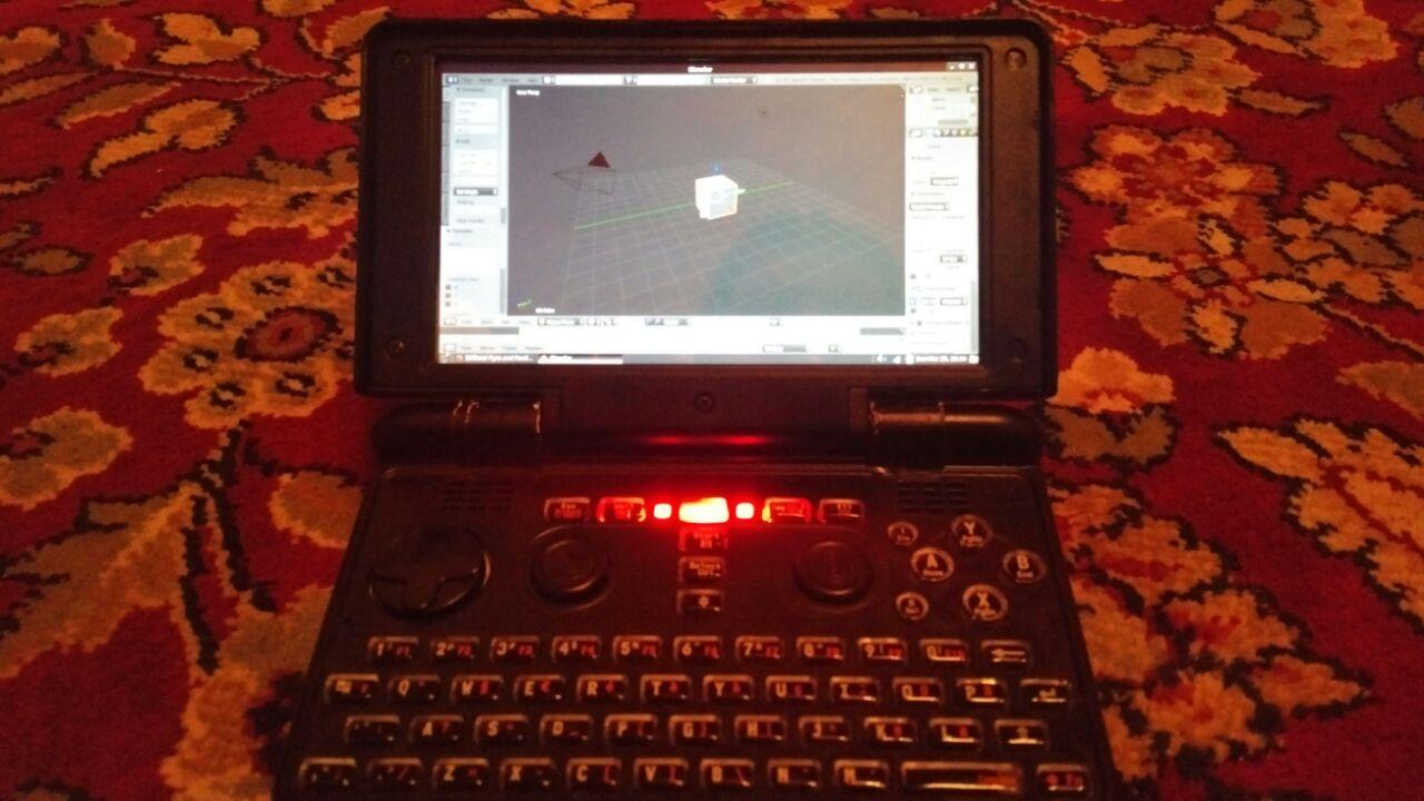

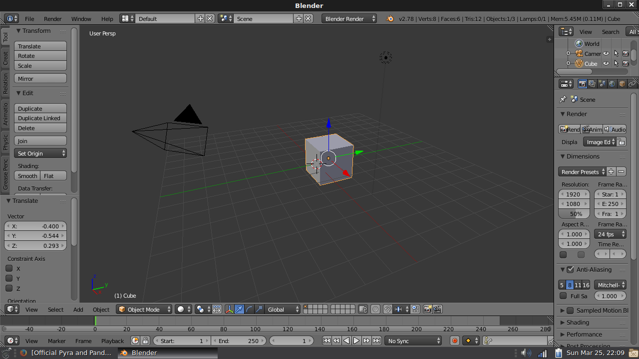

Here you go.
Pyra Blender installs out of the box.
I have not much idea how to use it.
If you have something small/mediocre for me to render and tell me how to do it let me know.
I have no GPU enabled. Does Blender use it? I suppose.
Dragging around the default rectangle feels not even that bad.
It's teleporting behind my cursor but it does not slow down the Pyra or mouse movement.

Here you go.
Ah, this is good news, I was going to get the Pyra regardless but this makes me happy. I don't really have anything to upload but I know it is possible to download a 'job' and ad long as the files are in the same directory it will work.
At this time Blender uses only the CPU for rendering but has experimental code for nvidia cards I believe but that won't work on the Pyra anyway.
Thanks for this, just knowing it compiles and runs makes me happy. Importing a 1080p video on it to chop it up, eh, I don't know.
You're probably busy but there is a youtube channel that shows how to set up Blender for video editing and he uses big buck bunny as a sample.
You know that I didn't compile it?
I opened up the terminal
sudo apt install blender
It's not Pandora times any more.
All standard software is in the official Repo.
