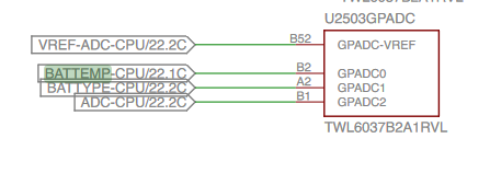

In pyra-thermal.sh we're reading the temperature of the battery monitor chip itself (bq27421) not the temp sensor from the battery. The bq27421 can report it's own temperature or you can tell it what temperature the battery is, it doesn't connect to the battery's temp sensor at all. The bq24297 charger chip does connect to the battery's temperature sensor but it only uses it to shut off when it's outside of a configurable safe range. It doesn't report the temp from the battery (the driver for it reports an estimate though).
At the bottom of pyra-mainboard-common.dtsi there's a device configuration for "battery-monitor" that uses a driver called "generic-adc-battery" which looks at palmas-gpadc channels 6, 11, and 1 for voltage, current, and temperature respectively. There's definitely something happening on channels 6 and 1, just watching the raw values at /sys/bus/iio/devices/iio:deviceN/in_temp1_raw and in_voltage6_raw, though in_voltage11_raw is suspiciously low whether I'm charging or not. (I've only seen 0, 1, and 2).
The generic_adc_battery module isn't loaded though, if I sudo modprobe generic_adc_battery though it logs iio_charge:0 in the system log then proceeds to immediately shut down the system.
[this is the driver for the ADC chip TWL6040]
It looks like the only source of actual battery temps is the palmas_gpadc channel 1 but idk if that's actually properly hooked up or how to get a celcius temp from the raw data (or get some driver to do it)
also IDK what the actual channel mappings in the palmas_gpadc driver correspond to though there's a Documentation/devicetree/bindings/iio/adc/palmas-gpadc.txt doc file that says
Which seems like the config in pyra-mainboard-common.dtsi is at least on the right track
Based on the schematics, the battery temp line does go through the cpu board connector and connects to the TWL6037 (palmas chip I think?) [yes it is] so I see no reason not to believe that the data from the palmas-gpadc driver is actual temperature data
I couldn't really figure out at the time how to properly get a good reading from palmas-gpadc, but I did modify my local pyra-thermal.sh to basically never throttle charging based on temperature so that I can actually use my Pyra more. I would be interested in making/testing a proper fix but I don't know when I'll have time to go looking for answers on how to get good data out of that driver myself. If anyone can point me in the right direction though I might be able to cobble it together quicker.
Note I found the data sheets for bq27421 and bq24297, apparently the sheet for the TWL6037 is behind a NDA or just not publicly available to download (from this TI forum answer). So if someone has that it would be helpful.
I also managed to dig up some more updates to the palmas-gpadc driver from the android source where we originally pulled it that I was talking with Risca about, it's probably worth updating it but it didn't seem to help me get good temp data.
the most up to date one I found was here VS the commit that letux got it from which is this one
Channels list:
0 battery type
1 battery temp NTC (optional current source)
2 GP
3 temp (with ext. diode, optional current source)
4 GP
5 GP
6 VBAT_SENSE
7 VCC_SENSE
8 Backup Battery voltage
9 external charger (VCHG)
10 VBUS
11 DC-DC current probe (how does this work?)
12 internal die temp
13 internal die temp
14 USB ID pin voltage
15 test network
