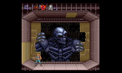

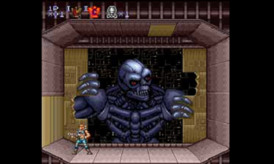

What Tyler wants is easily possible using notaz' framebuffer scaler (with SteveM's hack it works with SDL).
Either just scale the 256x224 pixels to 640x480 to have a nice full height using 4:3 mode or scale the 256x224 pixels to 548x480 if you prefer to keep the 8:7 format while using the full height of the Pandora's screen.
Some pics to illustrate the formats:
doubled pixels (that's the currently available mode):
256x224 scaled to 640x480:
256x224 scaled to 548x480:

Just MS Paint to demonstrate the dimensions. With notaz' scaler it'd look much better of course.
