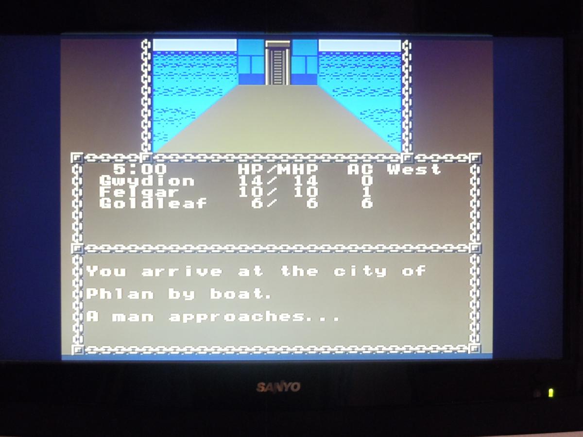

Ok, got it working sexy in the hardware/overlay layer, which is really where I wanted it to look nice anyway (emulators!). So GPFCE looked perfect once I configured the settings correctly.
I love this thing.
The image was cut off a little on the left side when the resolution was 720x480, so after some experimentation I realized I could just adjust the x (640x480 was perfect for me, with 50 starting x and 0 starting y position) and I was good to go. I was trying to adjust both x and y thinking I needed to maintain the aspect ratio. But adjusting the y was making things blurry in the emu.
Main layer is still blurry, but oh well it's not bad.

@Mantas, I think he was referring specifically to the settings in GPFCE (Nes emulator). A lot of the older systems can look very crisp because they have resolutions so low (and unprocessed with filters) they are well within the TV-Out's capabilities to display well - Snes9x4p looks particularly good! Hatari is very good too.
The rest will depend on the internal scaler of your TV if it's a flatscreen, some are better than others. If you have a DVR of some kind attached via HDMI to your TV, you could try attaching your TV out to that rather than directly to the TV, and seeing if there's any benefit.
