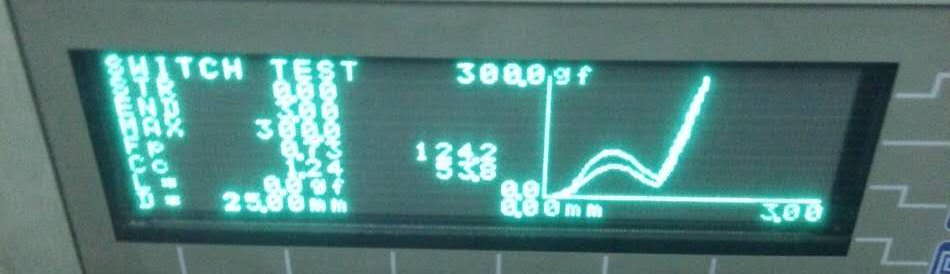

2. The keymat
The keymat company has done some accurate testings to make sure the keymat will work as good as possible.
There is special test equipment for stuff like that available, here is what a sample result looks like:
They also have a Pandora keymat as comparison, so we can make sure the DPad works as good :)
Test results have shown that the pressure point of the Pandora keymat actually was as good as it could get, based on the physical limitations (button size, etc.)
Still, some improvements can be made with the Pyra keymat like lowering the distance from the carbon pad to the PCB to get a smaller travel distance as well as using a softer material so it needs less force.
We decided to lower the carbon pad / PCB distance by 0,1mm. The moulds are already being adjusted, we can expect the (hopefully :)) final samples in a few weeks.
The samples will come in different material stiffness so we can choose the best one.
