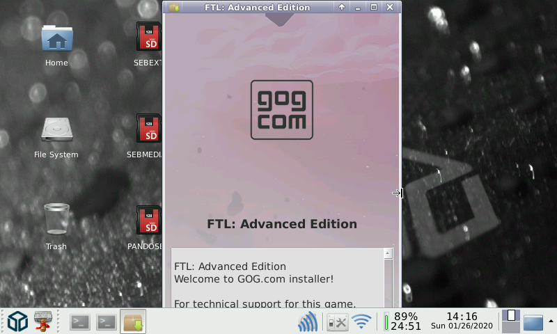

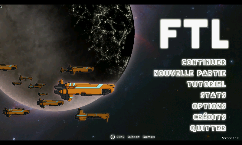

			Also, I'm surprised FTL is marked as non-working.
I have the Humble Bundle version, and mine has never worked so far. I've never seen a splash screen or a menu screen and just get a black screen. It may be the display resolution on the Gameshell. Perhaps the screen isn't black, but I'm only seeing the 320x240 top left corner, which is black?

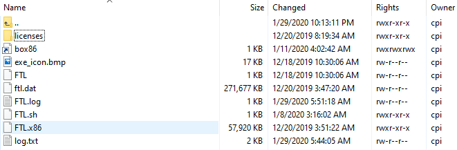

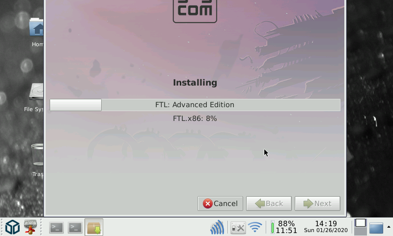

Here's what my FTL install looks like. It's pretty flat, and I don't think the licenses directory is needed but I didn't bother to delete it.
My shell script is simple too:
		Code:
		#!/bin/bash
export BOX86_DYNAREC_LOG=1
./box86 FTL.x86 > log.txt

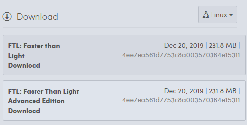

Oddly, Humble Bundle lists both versions of FTL, but the download is identical. So I'm assuming it's the "Advanced Edition".
