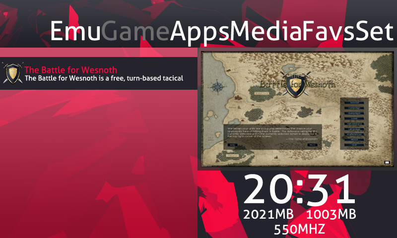

dflemstr said:
My PMenu skin.
I call it Colors.
Download.
Also, Cpasjuste, your program has a lot of bugs and visual glitches, and I'd be happy to report them to you and patch them.
Really nice, but I think the stuff in bottom-left is too crammed and doesn't fit the rest of the style... Maybe if you put the clock on the right and made the size information smaller and more spread out it would be better.
OK thanks for the feedback guys...
Does this look better? (I can rearrange the bottom widgets if you think it looks better but I prefer to have the clock where it is, because PMenu can't right-align text so the clock would clip outside of the screen if it was to the right)

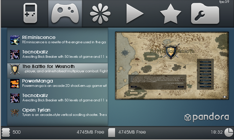

(naw)mcx said:
Thanks to all the guys who offered me help and helped me, you're all awesome :)
(dflemstr, tripmonkey_uk, trevsweb)
First peak at it actually running in pmenu
font could use some work
