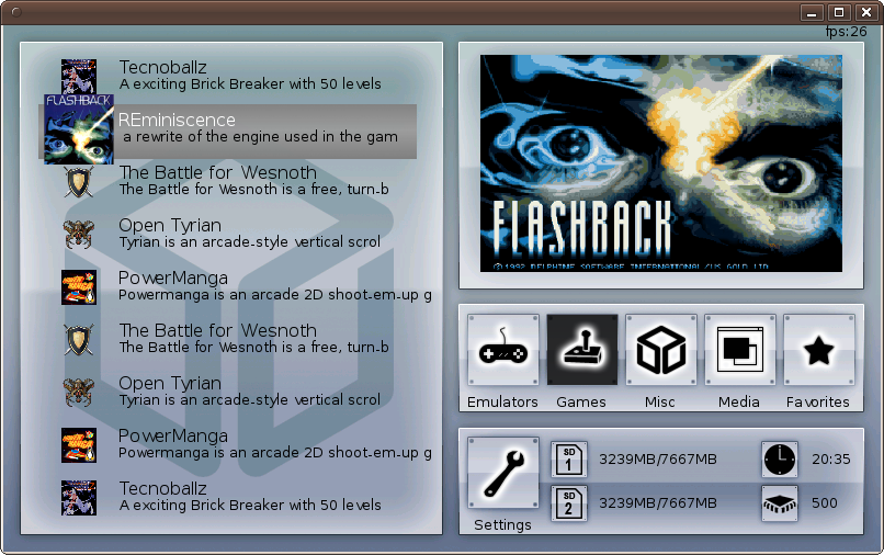

Looks like I had the time to update my skin after all.
Linky
EDIT: clarification

Updated my 2 skins:
Download: Platinum Skin
Just minor tweaks for this one:
Download: Glass Skin

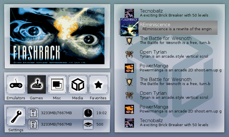

Hey MDave, do you think you could make a version of your Platinum theme with the left and right sides switched? (List on the left, everything else on the right.) Also, maybe putting the preview image in the middle (categories on top, settings+info below)? It feels kinda awkward having the list on the right. Not sure why.
P.S.: Platinum's great. Positioning of GUI elements aside, I'm still considering it for my default skin.

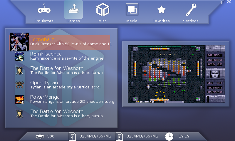

SlashEMc2k said:
Just in time for my next skin::
http://www.bluestudios.co.uk/pmenu_console_slick.jpg
This without the Xbox logos and possibly in some blue (maybe try to make the pandora text glow blue in some animated style? how about some sort of pre-rendered 3D animation until pmenu supports 3D?) in there.. awesome!
I thought along those lines for the blue, excuse my poor skills:
Here you go ;) I also updated the download link. Just rename the skin_flipped.cfg to skin.cfg and backup the original one to get the flipped skin :)
