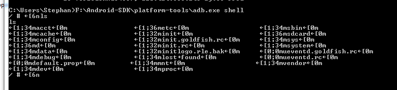

These are coming from busybox color support, should disable by default I guess.Attached the messed shell output to illustrate the problem.
The problem is even after a complete clean new installation of Android.
