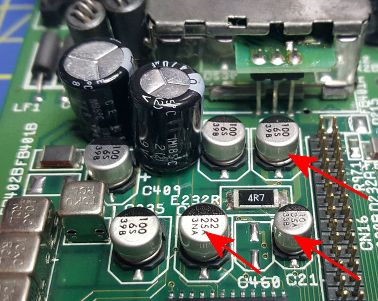

IT IS DONE! and it was one hell of a solderjob. For anyone who wants to recap their amiga: Do not twist the caps off or try to desolder them! The best method I found, avoiding to lift any solder pads, is to get yourself a decent esd proof wire cutter, and snip the smd caps off!
Since I couldn't desolder two of the bigger elko caps, I left those for now. Everything else is pretty much replaced by ceramic caps!
@xnopasaranx yeah my first attempt with my original A600 motherboard I tried to carefully de-solder each pad and it ended up lifting up a couple pads. Honestly on the second motherboard I attempted the twisting method and it worked well for me, but I could see an issue if there was already Capacitor leakage it may end up ripping the pads off, just because the corrosion already weakened the pads. I think If I attempt it again I'll try cutting the leads off like you did.
@TrashyMG don"t try to cut the leads. you will scratch the board. Cut directly through the cylinder of the cap, there is a small groove on the bottom right above the plastic base, that's the spot where you should pinch through it. that way the plastic base keeps the leads protected a bit. you can then lift the plastic off the remaining leads, or cut the leads further if the plastic is stuck. afterwards cleaning the pads is a breeze and you can immediately see if any damage is visible under the capacitor, before you decide on how to proceed.
Are these the type of caps you are referring to?
Did you order a cap kit or order all of the individual caps? If it was a kit can you post a link for me please.
I've found with the type of caps above that if you wiggle the body it will lift off the base leaving the plastic with the pins sticking out of the board, the pins are then much easier to remove.
Having said that I don't know it if I dare do that on an Amiga, and those caps above look like they have much more solder exposed to work with than some I have removed in the past.
Well I was spending a ton of time getting the values and finding the right sized Caps. but ended up just getting a kit from here : http://amigakit.leamancomputing.com/
price wise it about the same and the kit just eliminated some of the uncertainty.
There is a pulldown menu to select A600 or A1200 in the order form. I'd give a specific link, but it's different depending on location you choose on the site.
