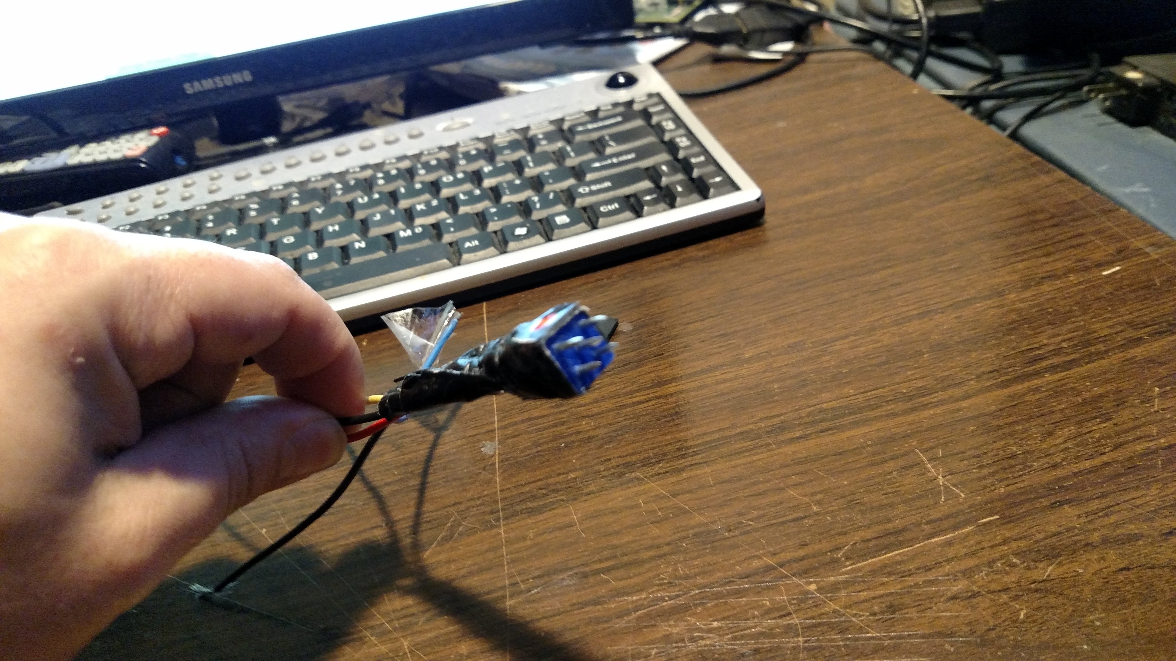

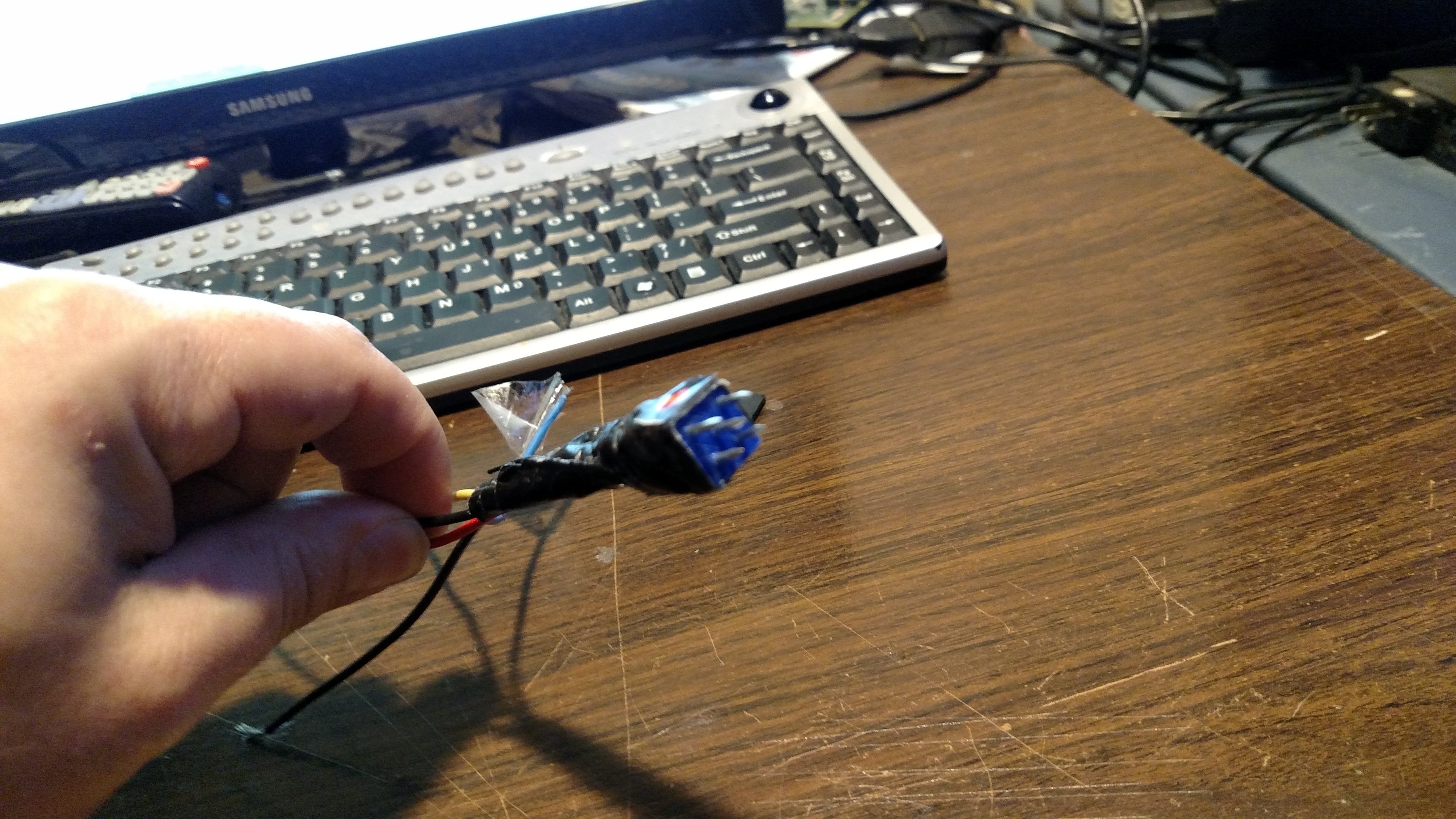

I had some pictures in the prior posts, but essentially I just crimped another 34 pin connector to a floppy cable (Amiga's can't use the double floppy PC cables with the twist). I made a floppy power cable with DPDT toggle switch to switch the +12V and +5V power from the real floppy to the gotek. unfortunately this setup doesn't allow use at the same time, but will allow both to function as DF0.
Ah! Okay I get it. I will see how I can proceed when everything has arrived at my doorstep. I guess I will exchange the FDD for the gotek first and then see what I can do. Thanks for the hints!

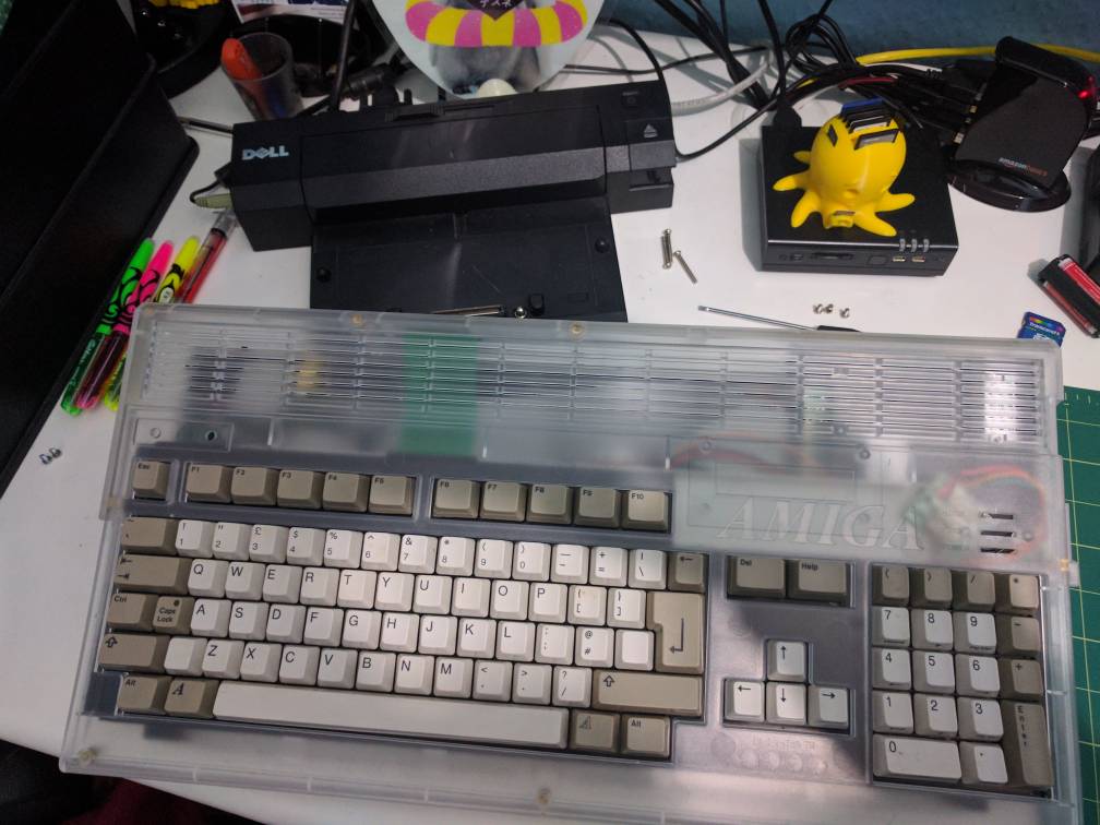

Just got a new shiny transparent case for my A1200. Just need to try to get it working properly now.
Next time you take pictures you should get one of the new case for us.
New cases are great, especially in fun colors (that is a hint, ED ;)). I wish there were some for more of my old computers and consoles, particularly for my main IIe, 100LX and Pandora. Metal ones would be even better.

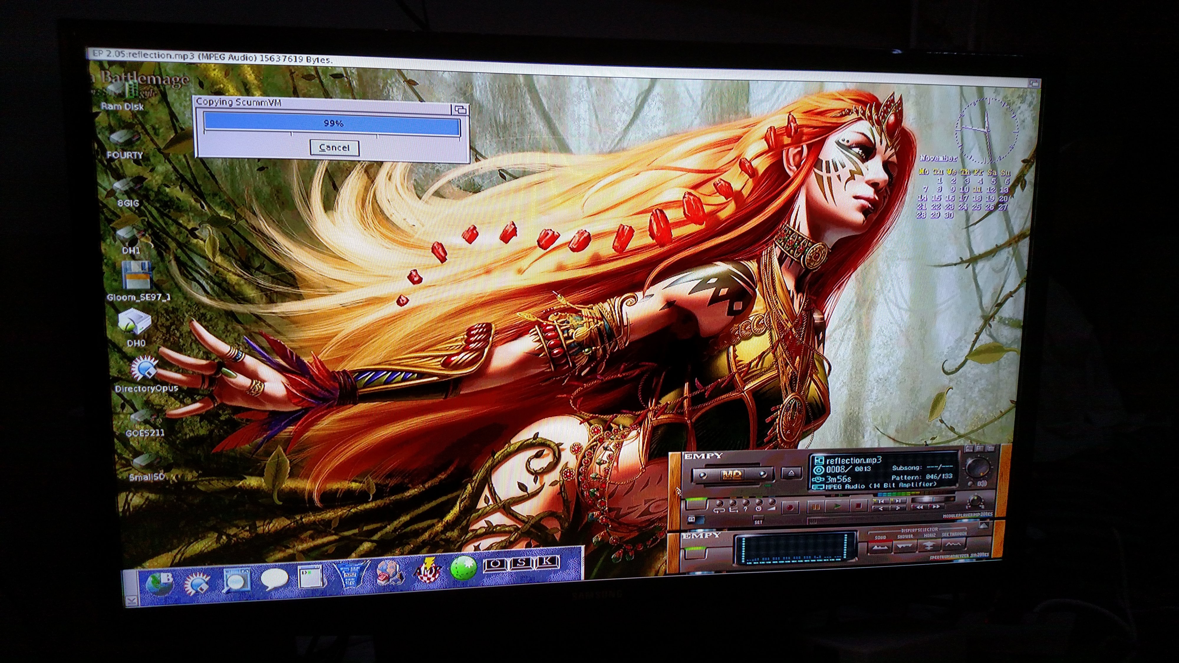

Well added another expensive item, I ordered a RapidRoad USB controller. which can allow a range of USB devices to work. On the A600 this works with the clock port built onto the A604n Memory expansion I picked up earlier. I guess on the A1200 it just works without any added devices. I guess now I need to figure out where to wedge in another two USB ports in the case.
Also a current screenshot of my Workbench. yeah the date is wrong, without a RTC, I need to have a script run when I start the internet to keep the date current.

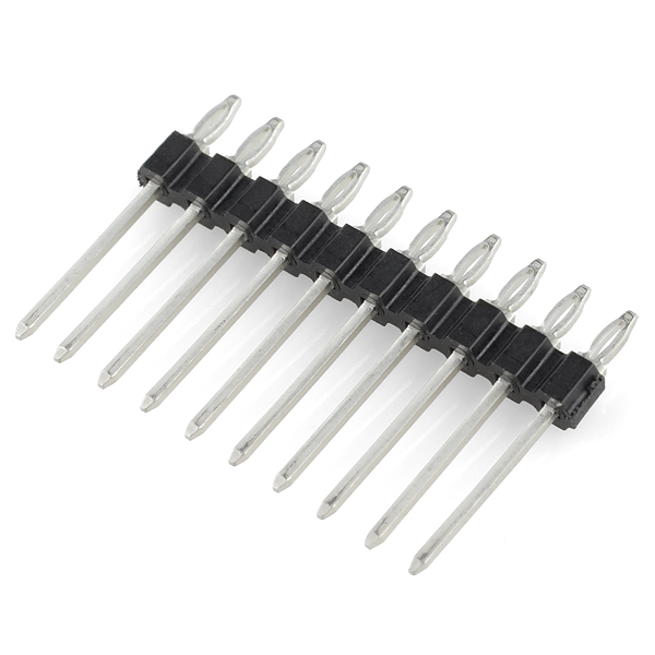

@Ian J - Well I did attempt to make my own with a small 3D printed plate and some small nails... it works but It fell out a tad too easily.
Edit: It was also a pain to put together.
Would using header pins make it any easier?
As they already have plastic round them I wonder if it would give the 3D printer plastic something to grip onto, these also look like they have something to solder to.
