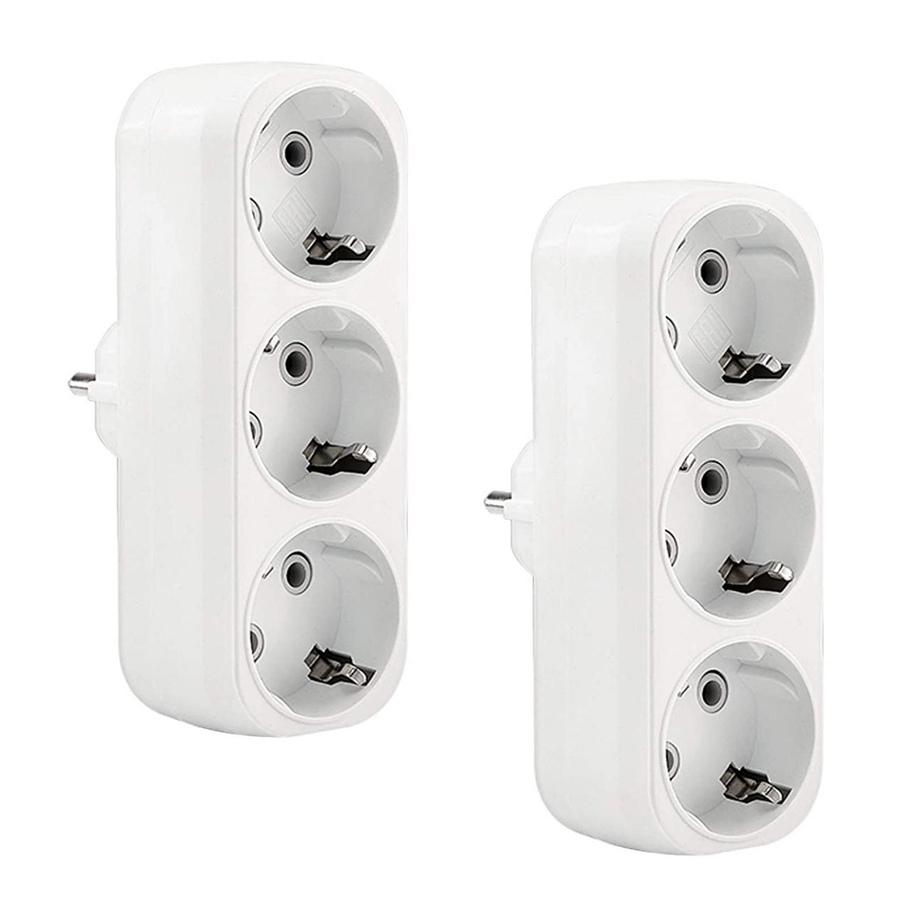

That's the product:
Now find the 2 errors in the following picture (it's on the same site as the above)

According to the orientation of the holes, the adapter would be vertical and not horizontal.
In the second image they aren't using the same plugs in the before and after pictures, probably because the 45° angle would have them look weird, plus I'm not sure the last fat plug would leave enough space to plug something next to it.
