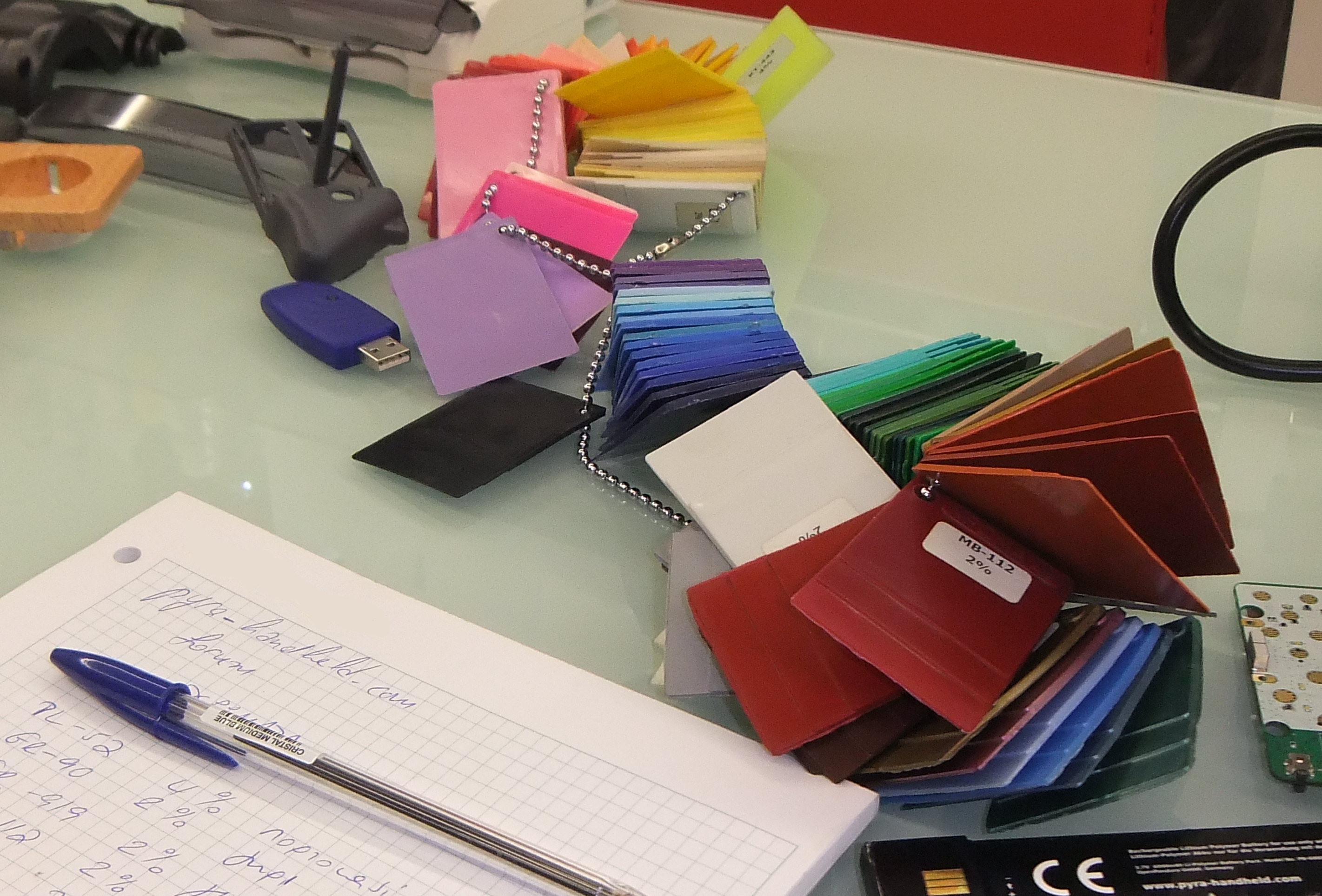

https://pyra-handheld.com/boards/attachments/27810/
that purple next to the blue usb stick....
but burgundy with a little gold glitter embedded in it....
clear...see through....
that wood effect
OMG my brain might explode..... the possibilities....

How many different colors will you choose for mass production? I might even prefer transparent, but that depends on weather the keymat covers all the LEDs, so they won't shine directly into my face.

Though this looks nice
I'm afraid it will end up like this after a while :-/
And I don't like the fact that it would leak light everywhere...
If it's going to be clear plastic I would be happy to pay the 30€ for something else.
And although I would like a C64 colored Pyra, I'm a bit worried by the Pyra logo on the lid as brown with white plastics won't look nice so maybe something like the coffee colored one would look better with the white pyra logo on the back...
Or just plain white... :)

I'm totally to give 30EUR extra for a "wooden" case. The nubs, wheel, and all buttons have to be in brass then of course. Steampunk Pyra, Yeah! (og and brass screws, of course...
Mate clear, paintable from the inside would be cool, too....

Everything looks to be excellent, so how will the case color selection actually work? You have 10 sample colors correct? Did you try a wide range of colors across the 10, or did you select several variations of basic colors, like 3 different shades of red, or a few of blue, several pink ,etc to see which "red" is best or where all 10 colors unique choices?
How will the final color selection go, do you have any ideas, or will it be something decided later? Do you have a set number of alternative colors that we will have at production? So will there be set number like 2, 3, or 5 choices for launch? Or can they be made to order at request, and that is where the extra cost comes in, and any color can be chosen at anytime? Or will they have to be pre selected and produced before hand?

Later tonight (or tomorrow, as I have to leave veeery early) I'll make a new post, with lots of informations about how the coloring works.
[doublepost=1453383347,1453383257][/doublepost]
Request wouldn't work. It takes about 3 hours to set up a mold for production, and we got 7 molds.
So it's 21 hours setting up just to get one color.
We might make 2 or 3 different colors for the launch, probably.
