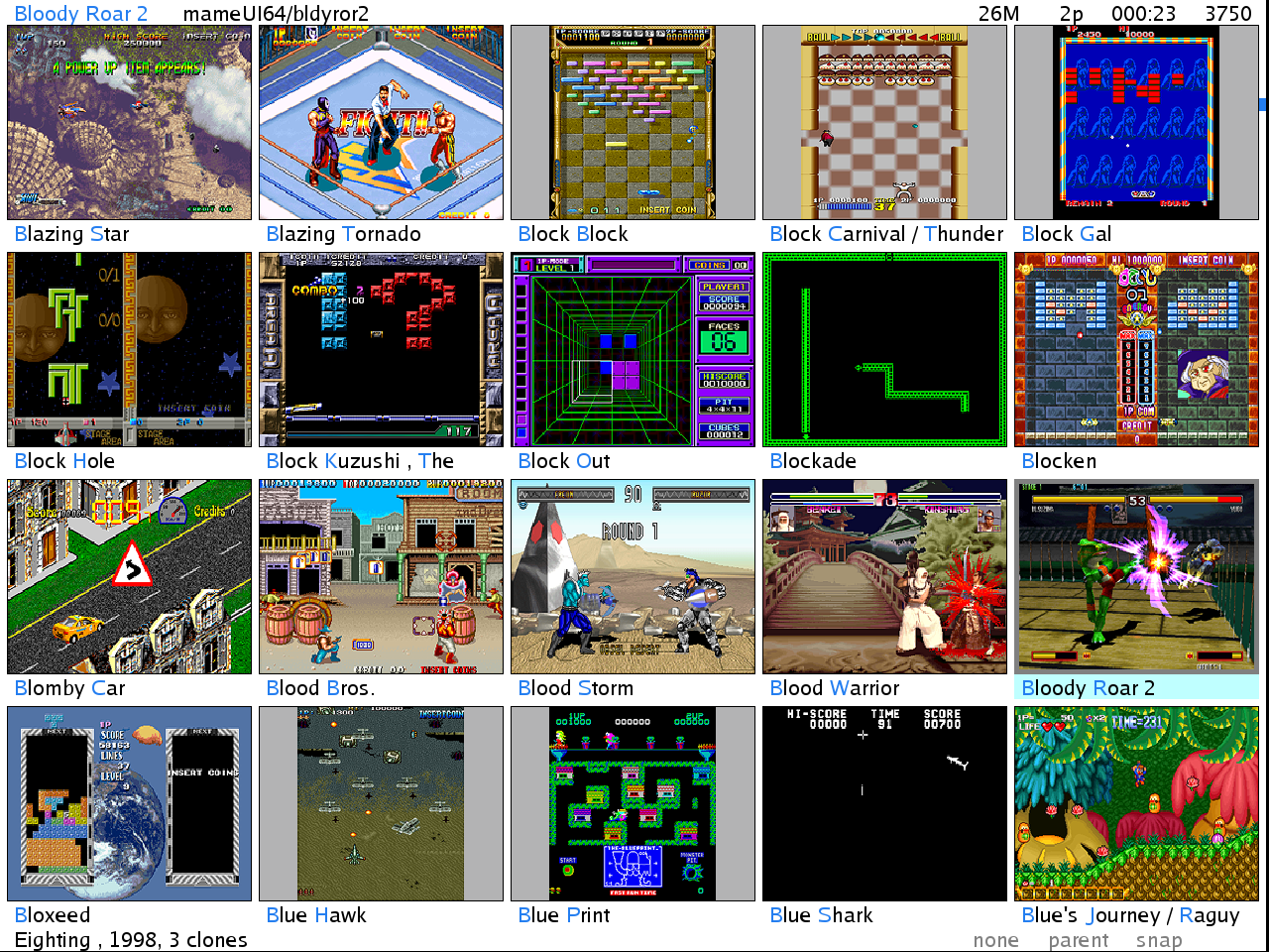

Q: What about the interface ?
A: All the programs are command-line driven, but AdvanceMENU is a very cool graphic interface that can manage more than one emulator, also the ones not "Advance" like the original MAME, or mainly anything that can start from command-line.

AdvanceMENU
- First start and configuration
- Extract the content of the archive in a folder and launch "advmenu.exe", it will give an error but will also create some needed configuration files.
- Open the file "advmenu.rc" with a text editor
- Add the lines for the emulators you want to use, with the correct path to the executables, for example:
Code:emulator "advmame" advmame "C:\advancemame\advmame.exe" "" - Manage also others emulators
